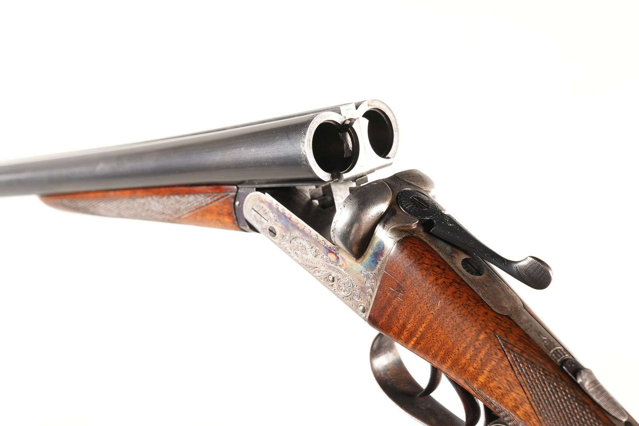

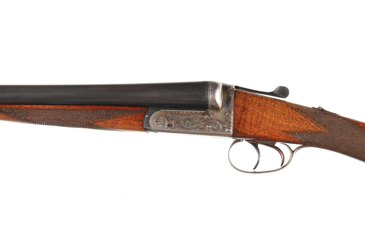

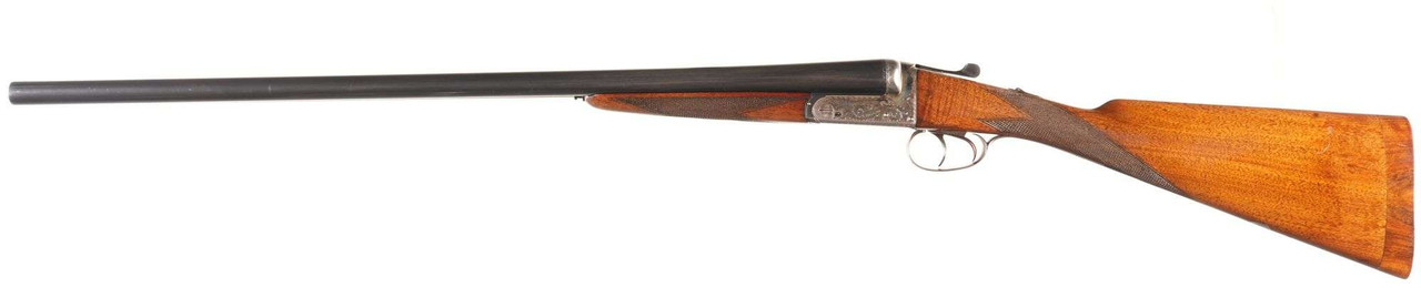

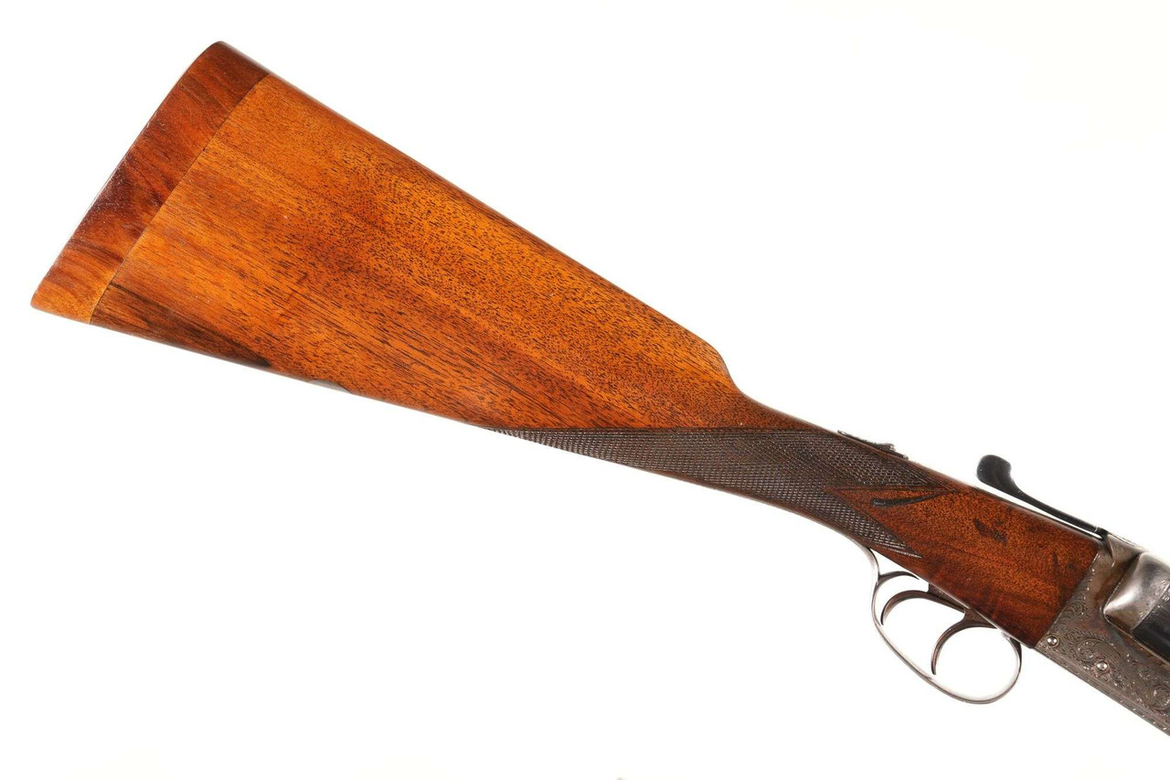

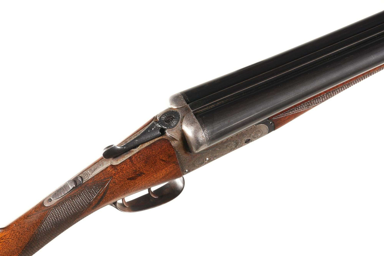

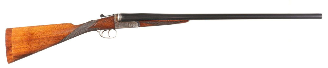

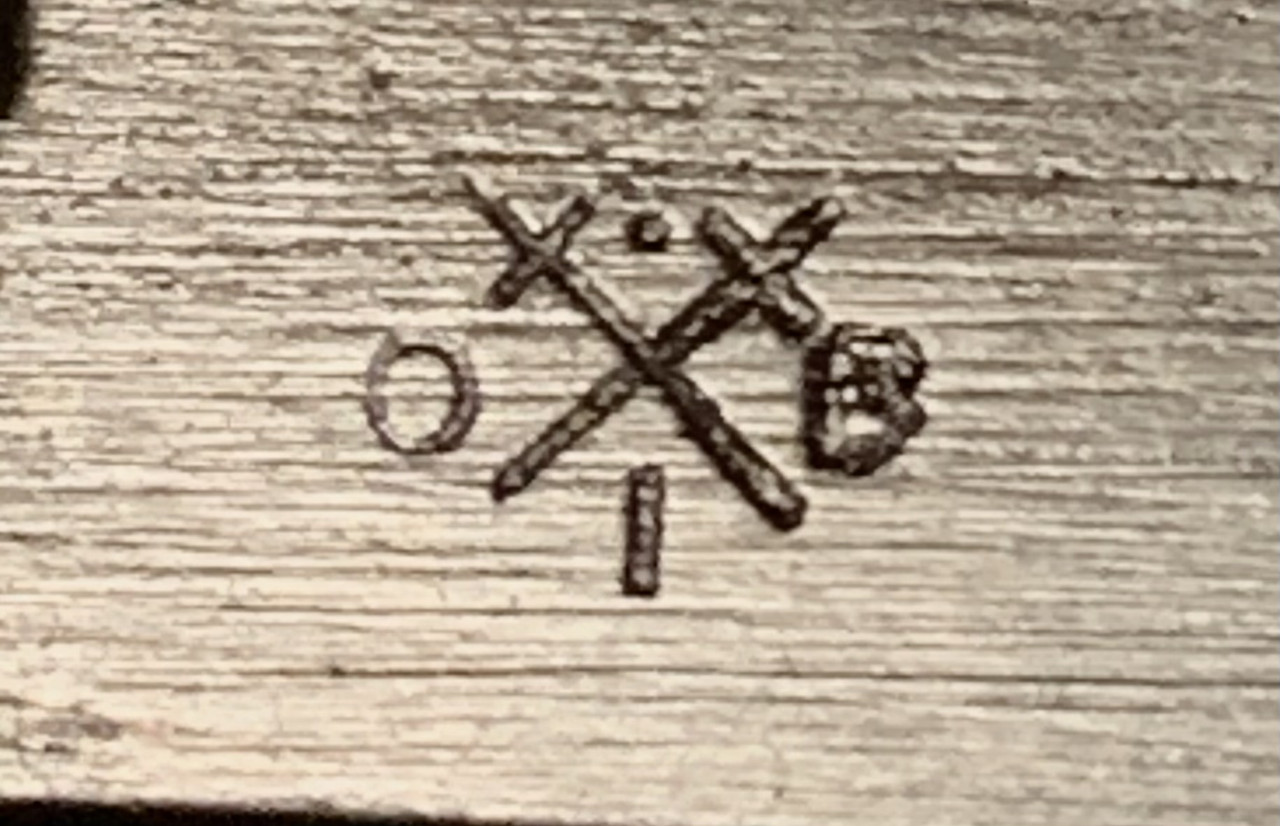

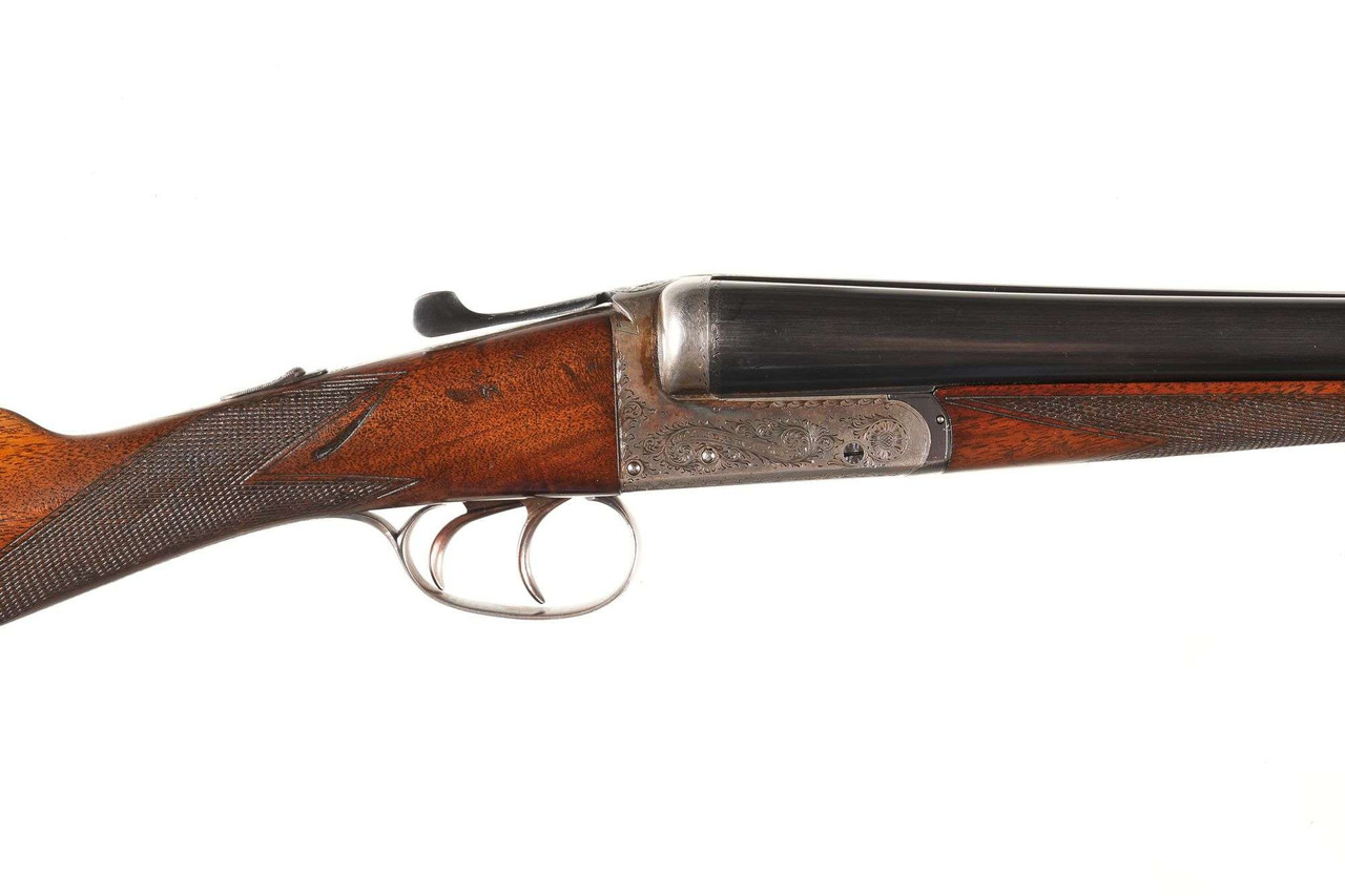

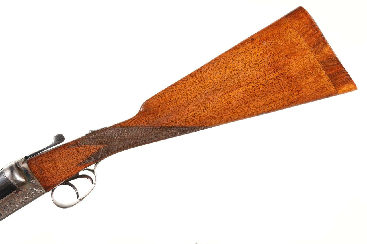

Picked up the Bland today.
It's kind of a disappointment.
It's heavy-ish at 6 3/4 lbs.
It's barrel heavy - the balance point is a solid inch+ in front of the hing pin.
Condition is good though, so it'll do well as a banquet or a prize gun.
Stock dimensions are OK at 14 7/8" LOP, 1 1/8" DOC, 2 1/4 DOH, with a little cast off.
This is the best picture I can get of the date code without getting out a better camera:
...maybe a double strike on the letter on the right side, but I'm sticking with the 1963 date I got above above unless someone sees something I don't see.
The rest of the pictures from the auction house:

Bland`s were known as specialists in wildfowling guns,6 3/4 lbs and 2 3/4 chambers is a recipe for a light duck gun firing 1 1/4 oz loads ...you got a gem.
I was thinking the exact, same thing. Just had a discussion on my Spanish gun that was 6 1/2lbs, with 3” chambers and proof. Not sure who thought that was a good idea.
