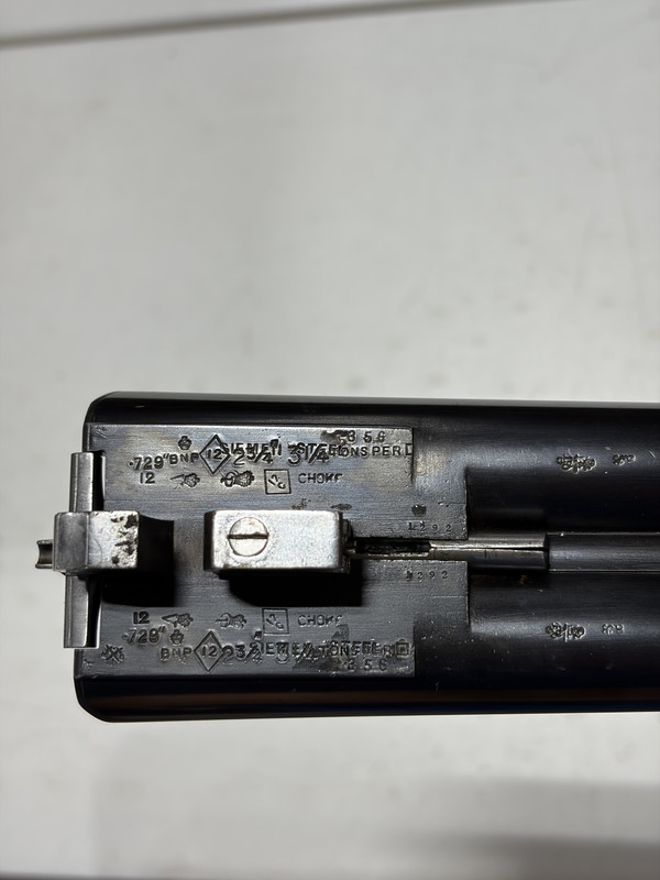

English SxS, 2 3/4" chambers, reproofed recently enough to have .729 bores marked, but not proofed for BAR...
What else can we see here?
...you should be able to click through and enlarge.

The image unfortunately is low resolution and very small
The original proofs were London, and the second Birmingham proofs are clearly stamped over the 'Siemen Steel'. I can't date the London Proof
The Crowned BNP (Birmingham Nitro Proof), and the .729" are 54' - 89' and the mark in the lower L is the Birmingham date code used 50' - 74'
If you'll tell us the letters within the halberds I can give you the date.
3 1/4 Tons is for a max. service load of < 10,000 psi
BTW: it those aren't enough proof marks, you can buy your own!
https://waffenamt-shop.com/gb/99-british-proof-mark-stamps

Looks like original London proofs might be 1887-1896:

Another reason that British Proof is ridiculous and should be ignored. British proof is stamped on guns with ten thousandths of wall thickness as long as the gun doesn't blow up at the proof house.
I did the <right click> then chose "open image in another tab) to blow it up.
Thank you.

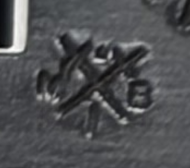

It looks like an "M" on the left, and a "B" on the right, with a "1" at the bottom.
Higher than a lot of English guns, and at least it's got 2 3/4" chamber.
That's just great...I'm sure there's no gun sellers out there who would use those to misrepresent a gun... wink
I really appreciate the step by step on that.
I didn't expect it to be that old with the 2 3/4" chambers.

I read it as 'M' also Geoff, which would be 1961
The reproof may have been following chamber lengthening since the .729" bore would be the original '12' ie not honed.
That would make sense.

Yep. Lot's more fun smile
MAXm confirms 1896-1904
Birmingham date code 'T B' - 1968
London Proof 2017
Bore 13/1 = .719" - .728", then .729", then 18.7 mm = .736"
