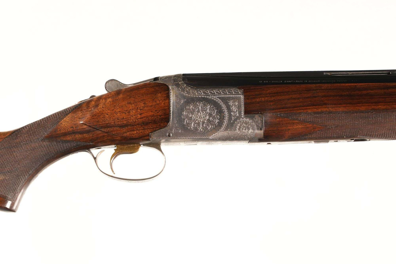

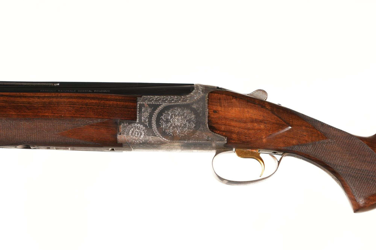

I've seen similar before, but am CRSing on what it it looks like.
It's not the same as any of the other four Superposeds I have on hand.
I've found several more Superposeds on line with triggers that look the same, so far, all have been FN guns, not Browning marked.
The gun (and all the other ones I've found online) appears to have the standard Superposed selector on the tang mounted safety.

Got 'er figured out: It's an "Olympic", or "Olimpico" trigger.
An upgrade for target guns, which this one pretty clearly is.
Supposed to be more adjustable/tunable for trigger pull, and it's mechanical vs. inertial, which is good, even though all Superposed triggers by 1978 should have been that way already.
