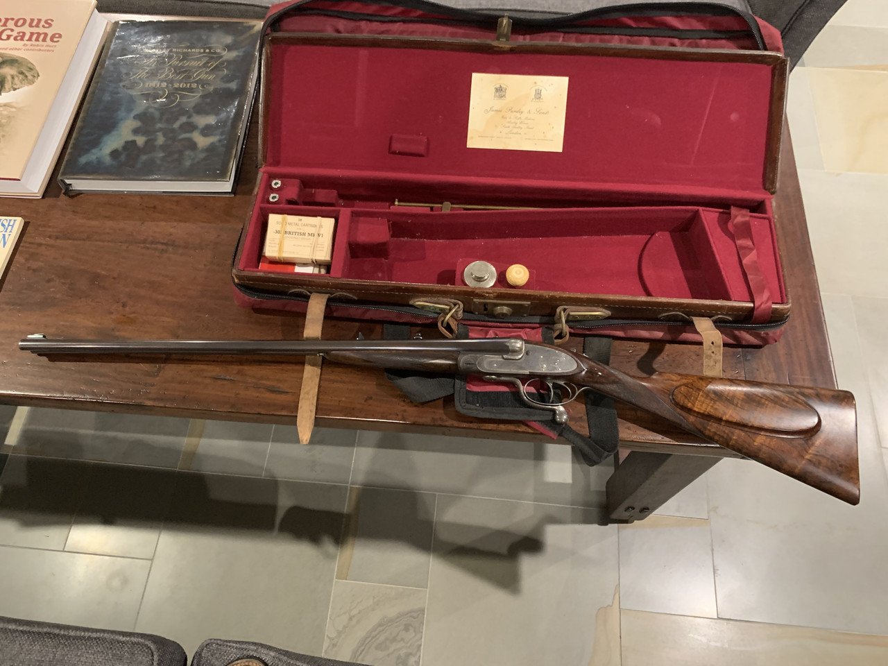

I have received a nice photo of a Purdey gun with a straight stock.
Wanted to share with all
Anyway, if someone else can share more examples, I would really appreciate it.
3 members like this: Jimmy W, Parabola, earlyriser

I assume from the cartridge box in the case that the Purdey is in .303 British.
Interspesting they were still using the Jones Underlver (or an improvement), or “Lever Over Guard” as they would term it.
