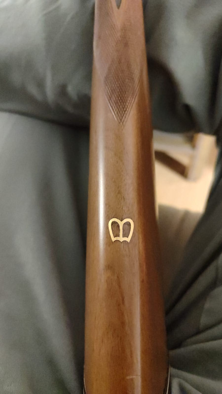

I send you a sample of a family symbol, place directly in the stock... Not gold, why would I need gold? I suspect it to be brass. But the result for me is second to none.... Fit an oval with the symbol engraved... it is not the same at all, at least for me!!!

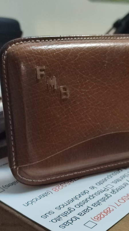

But here is an example of my dads business card holder in leather, with the initials in brass . The letters have a peg that is bent inside. Again, letters could have been stamped as usual, but placing metal ones, gives a quality and detailed aspect (I think)

Many Many thanks for the link, I will try to contact them.
Yes, cutting individual perfect letters in silver, brass or gold is difficult. But nowadays with small CNC routers, and /or laser, it is very easy to cut letters.
And you are correct, you need to solder a peg
This is a short video I made of the process of cutting a symbol and placing it in the stock. Not bad for my first time jajaja
