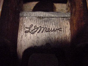

A VERY NICE RIFLE ..... BUT NOT A LEONARD MEWS RIFLE ... not his checkering pattern, not his grip cap, not his forend tip.
Also, Leonard marked all his work, even during the time he worked at Weatherby .... his custom stocks were marked in the barrel channel ... if he only checkered a stock, he put his stamp under the butt plate. Stocks done at Weatherby only had his initials, not his stamp.
Leonard was a fellow club member here in Appleton, Wisconsin. I collect his work and I have a dozen rifles in my collection.
http://www.yostaction.com/images/stamp.jpg
[Linked Image from yostaction.com]

Buckstix, Would you have any idea who the maker might be? The reason I thought Mews built it is a picture of a rifle he built on page 142 of Monte Kennedy's Checkering & Carving of Gunstocks that has the exact checkering pattern on the grip and forend.

No, the pattern on page 142 is Leonard's "Rocket" pattern (smooth teardrop) Its much different than the pattern on your rifle. Not sure why it wouldn't be identified since its a very professional job. I have the same problem trying to identify the work on these two of mine.
