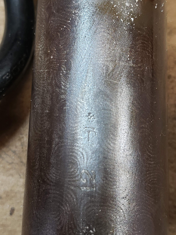

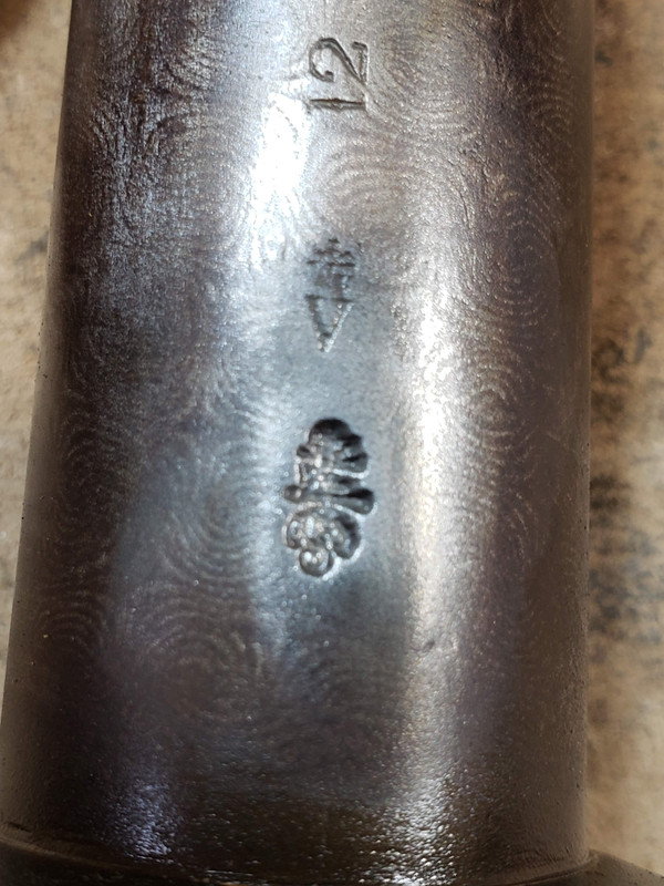

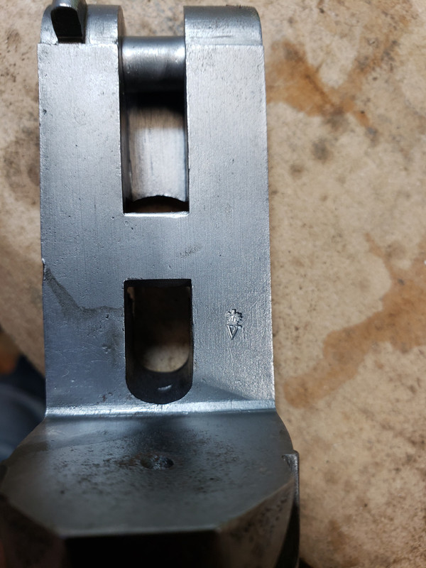

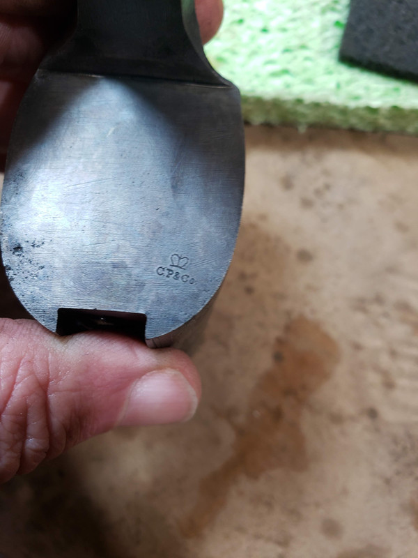

I picked this up from a member as a nice project for restoration. I have found a few marks on it I cannot identify and there are a couple of marks that are almost gone. When i try to find the Crown over C.P & CO I cannot find anything other than a reference to some pottery. I did figure out the crown over V as being a View mark from London proofhouse. Any help with i identifying the maker and age would be appreciated.

I think C.P. &Co.is Charles Playfair abd Co.

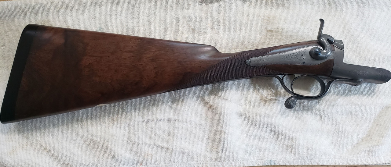

Its going to take a little while to get it back in order. I am having to learn how to to barrel browning and there is some other metal refinishing to do.

Here is peak at the Stock and metal. I had to make some choices regarding potting vs saving the engraving. I opted for preserving the engraving as much as possible. I found out about die maker stones and ordered some. They helped tremendously. If you are not familiar with them, think of a stick of sandpaper. They are like slip stones but come in various grits. I was able to use them right up to the engraving to remove pitting. I wanted to do a French Gray finish on this so that it would contrast with the browned barrel. I tried a little bit of coin finish first and didnt like the combination between it and the barrel. All screws and pins are nitre blued. The checkering was worn flat but the lines where still there. The closest size cutter was 20LPI. I remarked the lines and then pointed with a 90 degree cutter.
The stock had some dings and dents that were filled in or steamed out. Sanded to 400 grit and then Timberlux applied.

I really like your project. I’m a fan of single barrel shotguns. Please share more pictures and info as you can. How did you accomplish the French gray finish? I like that finish. As I understand, that finish is often achieved by first color case hardening and then rubbing the color back to gray. I’ve done some simply using Brownell’s Oxpho Blue applied in multiple coats and rubbed back with a Scotchbrite pad. Again, please share what you can about your single barrel project.
