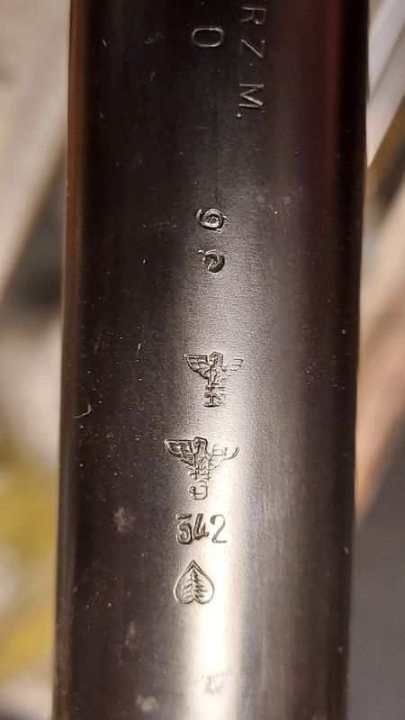

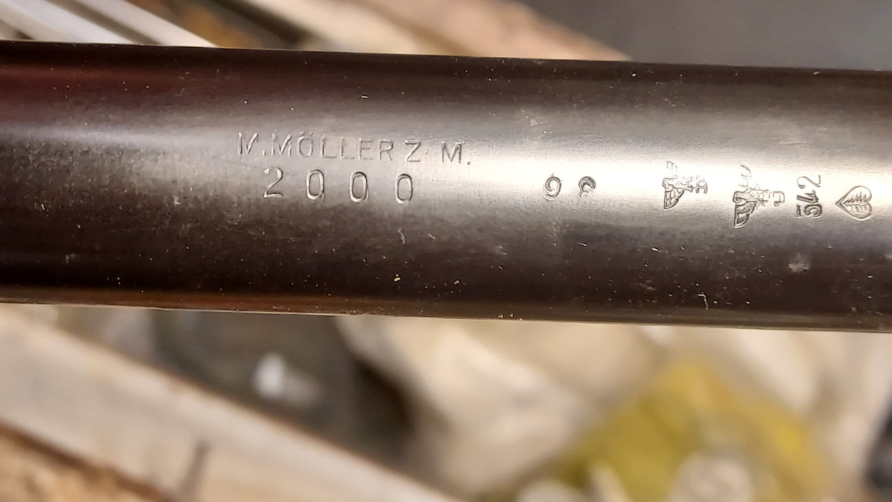

Picked up an (M. Möller Z.M.) 6.5x57 Mauser made during the Nazi years. Don't trust my memory to date it from the marks.

Yes, I will get some pictures.
Was hoping for the website as I am really just looking to date the proofs.
German Hunting Guns didn't have, or I couldn't find, the information.

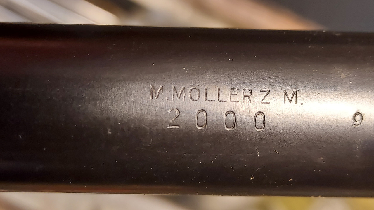

The date seems obvious, but what is the "2000"?
