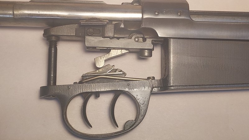

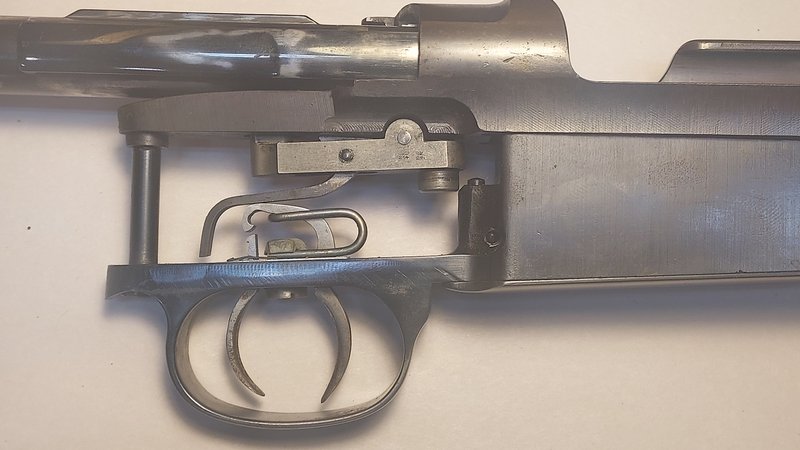

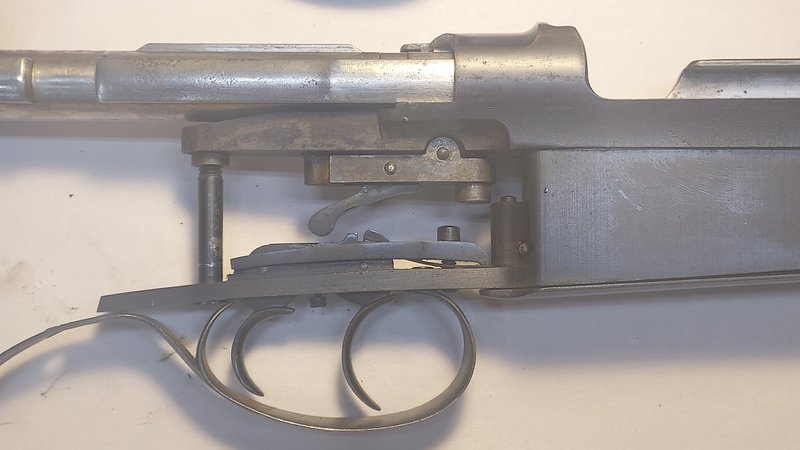

Zastava factory type:
Installed on a very nice "Johnson Automatics" rifle:
Installed on the rifle in the opening post:

Same basic principle as the Pacific triggers in my Krag.
(Smaller trigger is the "setting" trigger, larger trigger is pulled to fire it.)
