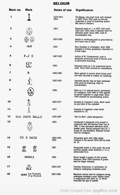

I see it as FB AF , which would mean: Fabrique Belge d'armes à feu
Look here:
https://mallorquina.pagesperso-orange.fr/source/pageF.htm
W-heil,
Wolfgang

Police used as seriál number 95571760..for registration. Is that correct? I thought that there are 2 numbers which one of them is a serial number and other as which it passed through proof house for example as 9557th in certain year(letter c - 1924)?

Thanks as always Wolfgang.
Not listed here
http://www.littlegun.be/arme%20belge/a%20a%20artisans%20identifies%20gb.htm#F
The Belgian Proof House did not use numeral date codes; lettre annale started in 1922

Thank you! It looks Like there is letter c in front of 1760 on water table. Im not sure. I cant see it on the barrel thou.
Waiting for the owner to at least slug the bore, to take any measurements he can...

Yes, I see the 'C' but the lettre annale were usually on the barrel flats, and a stylized lower case 'c'.

Also: The caliber indication 16 in the rhombus means the gun was proofed before 1924....!
Waidmannsheil,
Wolfgang
