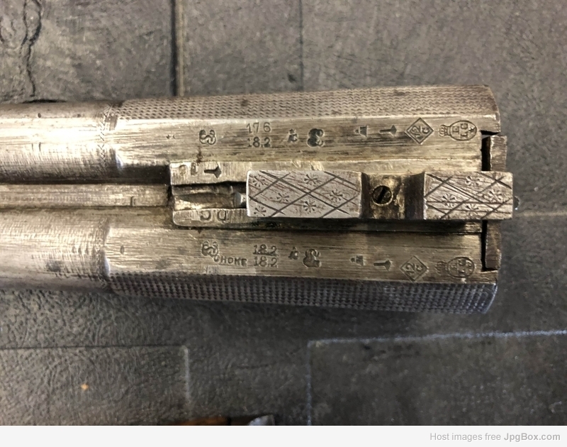

Finally got jpegbox working again. had to get new password. Somehow 62,000 pics showed up in my uploads!
Anyway, here are four pics of the gun to add to the knowlege here:
[img]http://[IMG]https://www.jpgbox.com/jpg/69495_600x400.jpg[/img][/img]
[img]http://[IMG]https://www.jpgbox.com/jpg/69494_600x400.jpg[/img][/img]
[img]http://[IMG]https://www.jpgbox.com/jpg/69492_600x400.jpg[/img][/img]
[img]http://[IMG]https://www.jpgbox.com/jpg/69491_600x400.jpg[/img][/img]

For Hal
Proofed in Belgium, made before 1922, 12 gauge short chamber
https://www.shotguns.se/html/belgium.html

Your gun is interesting Hal. It is a Pieper Diana Breech. Here is a Pieper J. Manton & Co. Modified Diana with another (odd) breech treatment
It should be an early gun, but the proof marks date it to 1910-1920. Pieper was known to use 'D.C.' for some reason.
The R barrel is Cylinder with a bore of 18.2 mm = .717". The L muzzle constriction is 17.6 mm = .693" = .024" or IM
Looks like a 'gunsmith' pounded on the barrel lug to tighten the FE?
And the L firing pin may be a nail?
Note Dave's Sears ad lists "Royal Damascus Finish" meaning Faux Damascus, likely décalcomanie over decarbonized or fluid steel; Pieper was reported to use Siemen-Martin from Cockerill which was good stuff.
Your gun looks to have the same process.

Looks like the finish work was done with a sledgehammer and cold chisel
