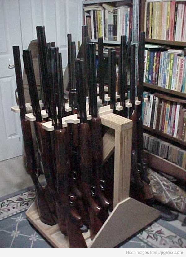

Does anyone store their guns muzzles down per recommendations to avoid oil seeping into the stock and action? Most gun racks aren’t made that way, and you rarely see pictures of such storage.
I would really appreciate photos of those sorts of racks as well as any pictures of gun rooms.
Kindest regards,
QD
The empty slot is for my Remington 3200 in 16 gauge
Just turn the picture upside down for a muzzle down aspect smile
