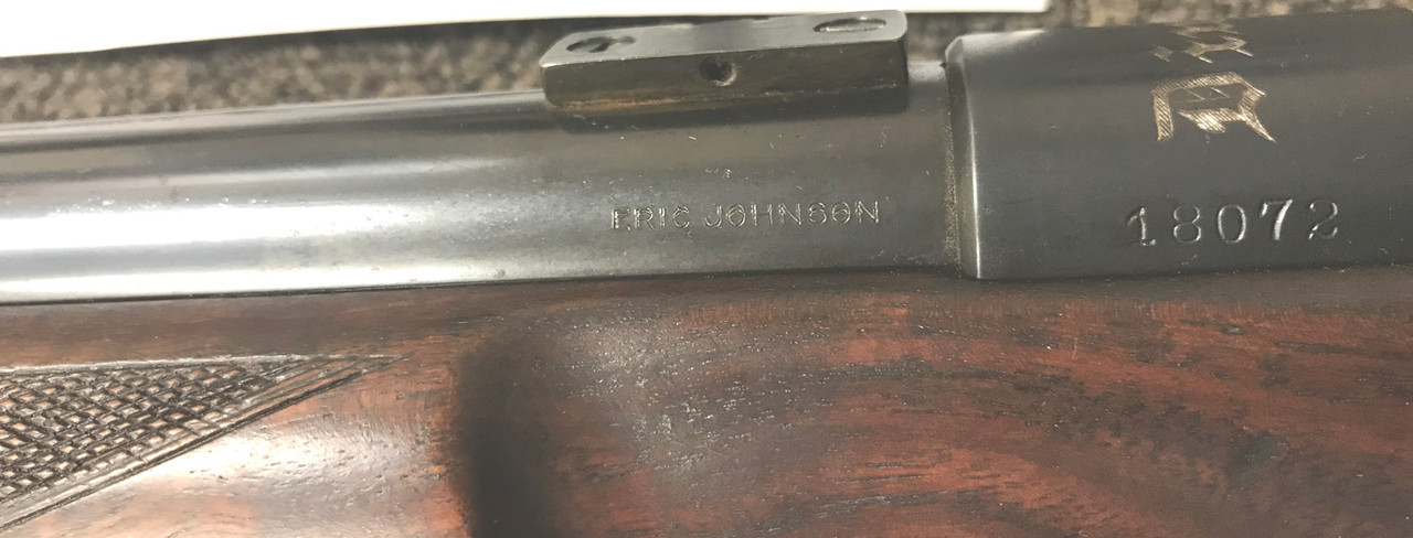

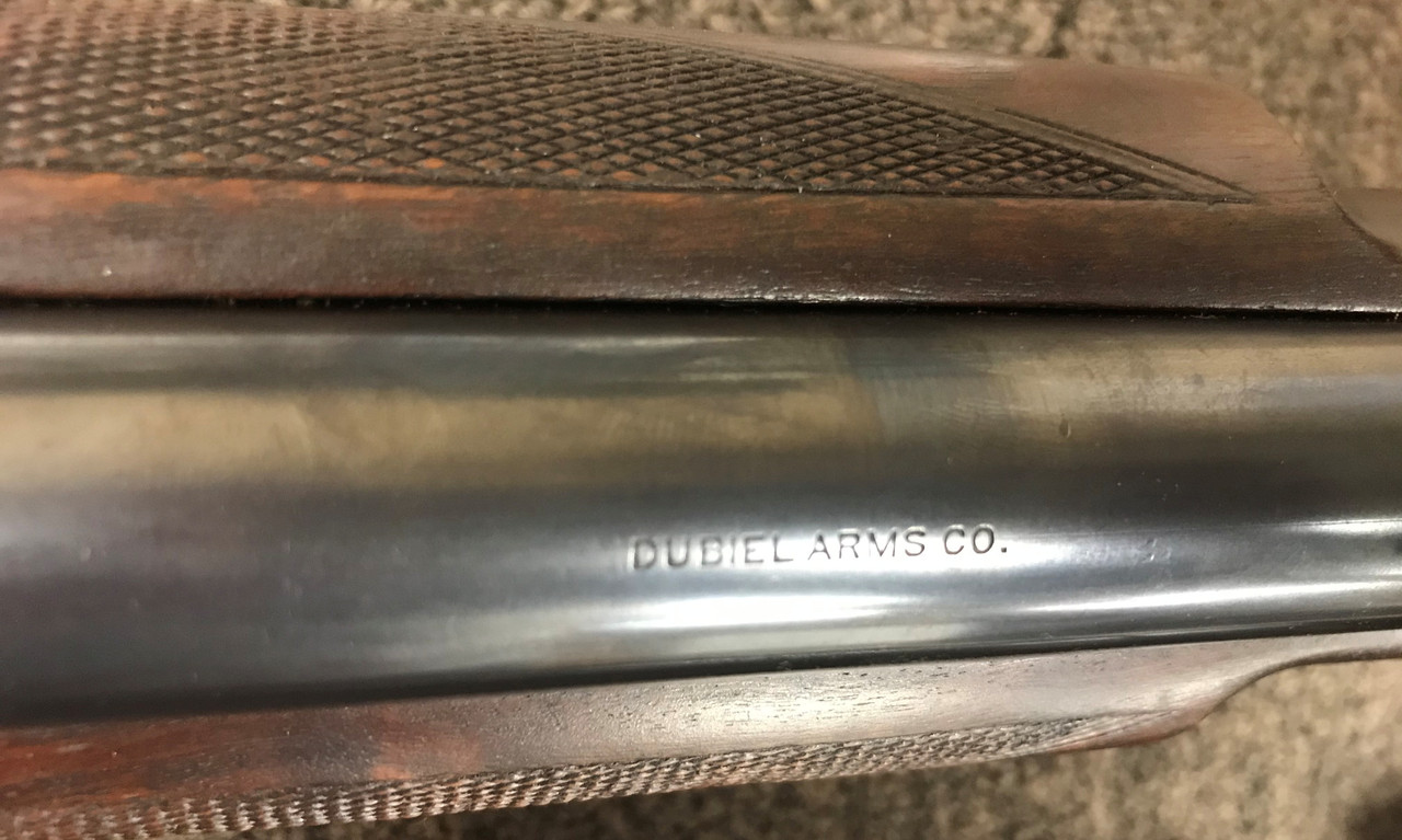

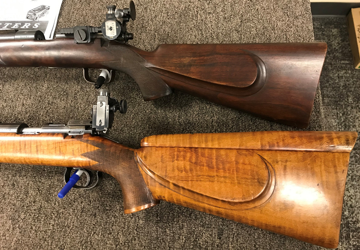

The Pope rifle has the same DUBIEL ARMS CO. stamp on top of the barrel as my SN 19011 gun.
The rifle is SN 18072 (per Houze, SN applied ~Feb 7, 1929); there is a Winchester proof mark by the SN, but it's very faint.
The left side of the barrel is marked "ERIC JOHNSON".

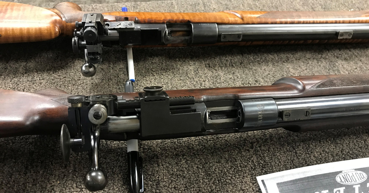

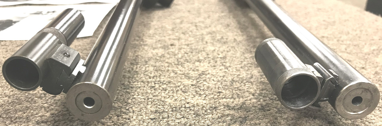

The muzzle on the Pope rifle is recessed and in the white, like SN 19011, but the recessed diameter is a bit smaller. The Pope rifle has a small barrel band above the hand stop. Length & diameter of the two barrels appears to be identical.
The rifle currently has a Lyman 524J rear sight and Griffin & Howe front sight, although for the Pershing Cup it was listed with a Marble-Goss rear and a Vaver front. There are also earlier photos showing a left-side mounted Lyman 48 sight, and there was a Vaver front sight in Mr. Pope's range box.

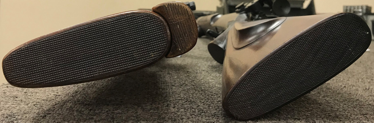

Compared to SN 19011, the fore end is wider and the cheek piece is thicker, as the stock was customized to the shooter. The checkering pattern is a bit different between the two, including the checkering pattern at the butt. The Pope gun has the holes at the top of the buttstock for the riser, but the riser is missing.
The wooden hand stop / front sling swivel is the same, as is the absence of a rear sling swivel.
The Pope gun was originally configured to use a magazine, but was changed to single-shot, with a wooden insert covering the breech guide opening, as with SN 19011. The stock also shows inletting for a wing safety, which has been removed. The action was not taken out of the stock, so no info on markings under the barrel or on the trigger.

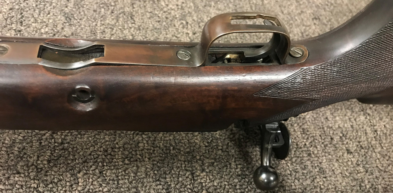

The trigger guard has a window cut in the bottom for an aftermarket trigger. This window appears in the September 1938 US Dewar team photo (below), but, while difficult to see, the trigger looks different (original?) in the May 1937 photo with Thurman Randle (below).

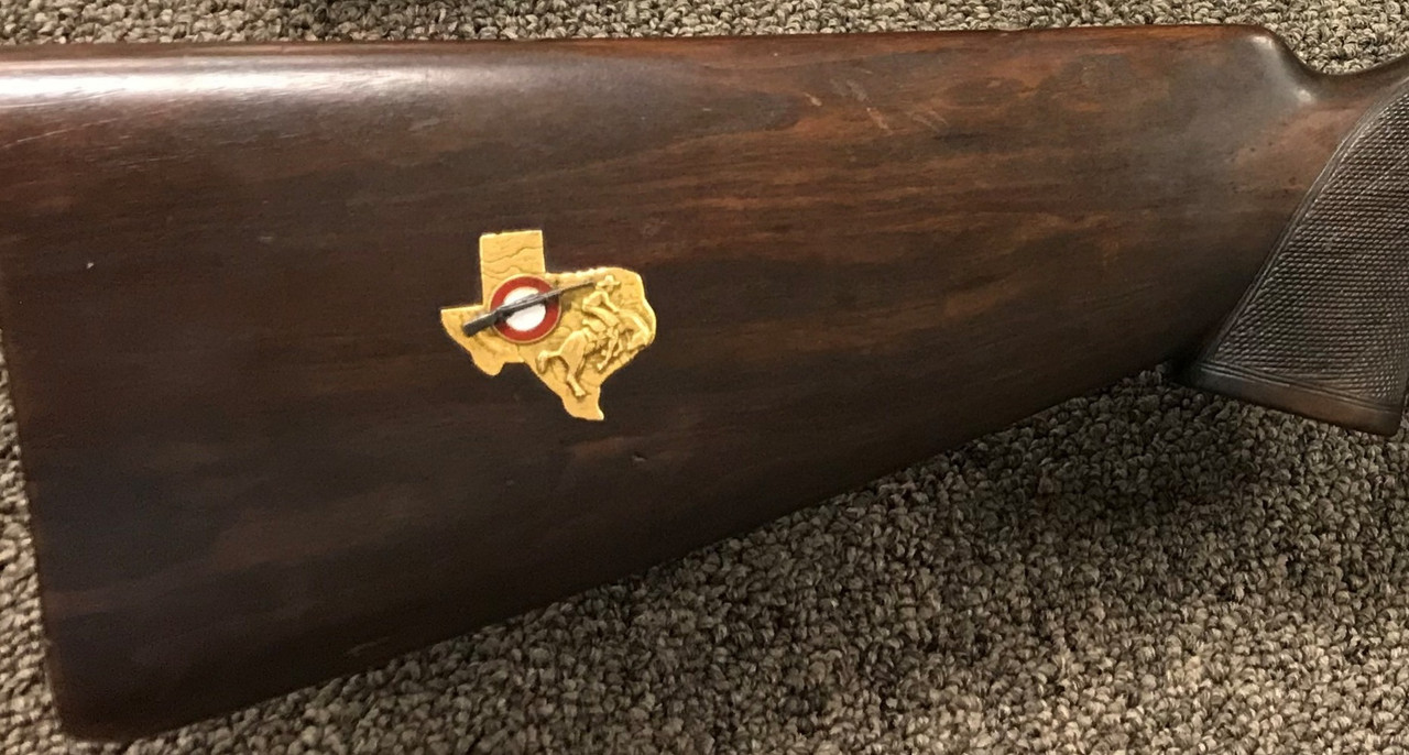

Pope displayed his Texas pride with a Texas medallion inset to the side, which may be related to his winning the 1935 and 1938 TSRA championships with this rifle.
QUESTION: Does anyone recognize the Texas medallion?

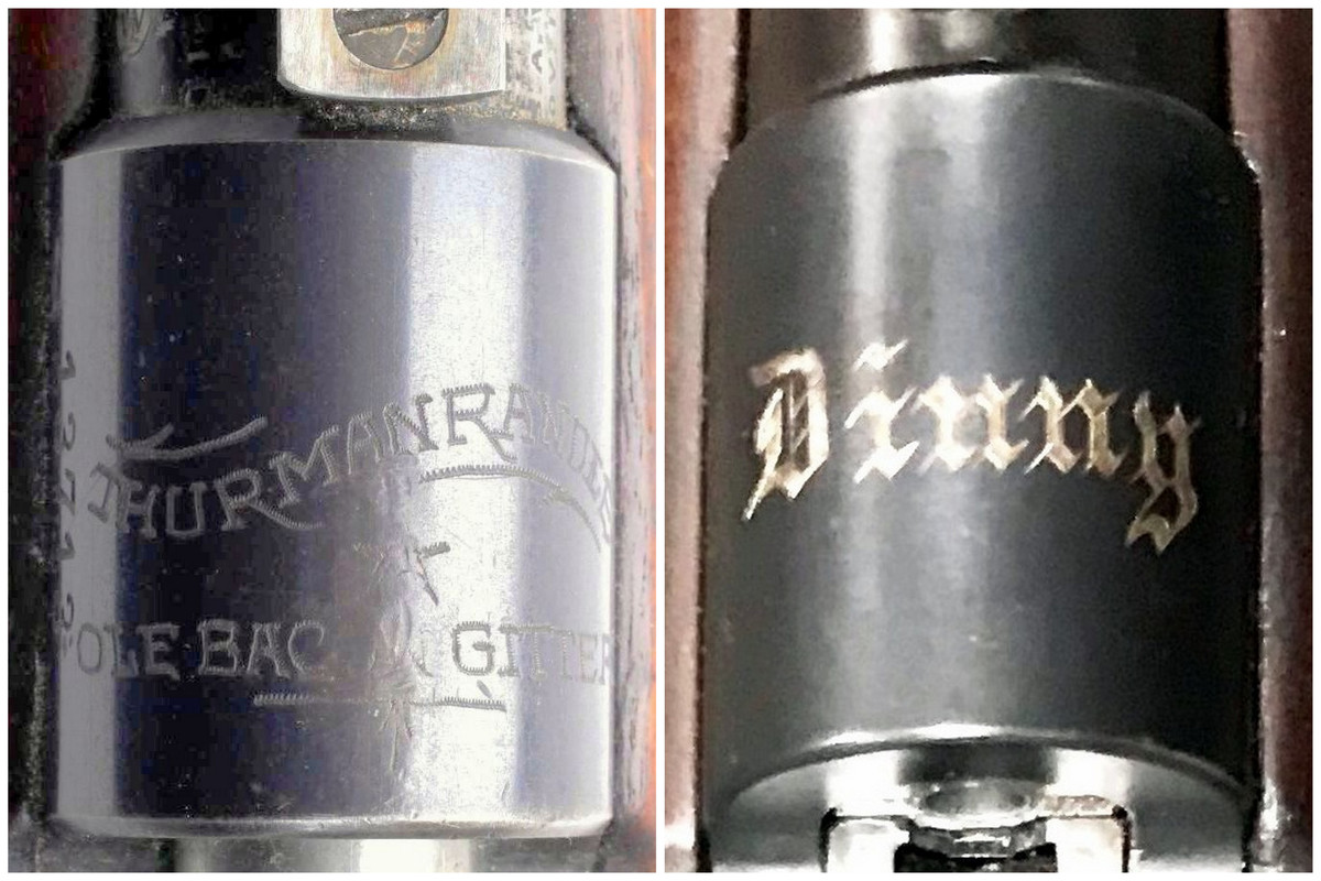

His rifle was named "Dinny", with the name engraved on top of the receiver.

An August 1938 AR article notes that Randle had installed a trigger by "gunsmith Wright of Fort Worth", on Ole Bacon Gitter; likely this is also where Pope got the custom trigger for Dinny.
QUESTION: Does anyone recognize this trigger?

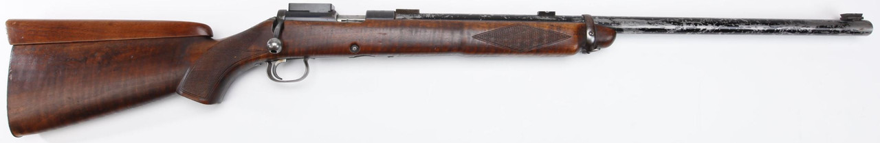

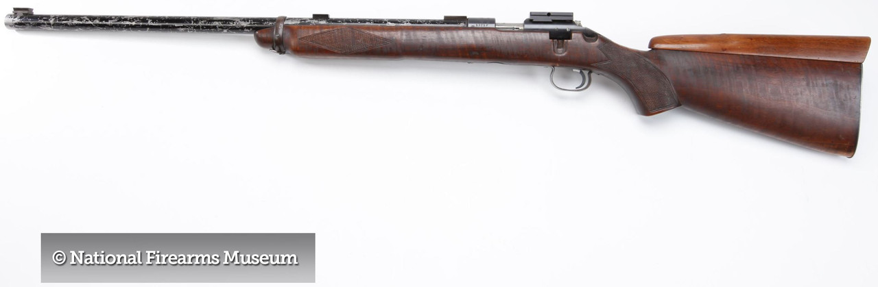

Ole Bacon Gitter, which Randle bought new in 1927, now resides in the NRA National Firearms Museum: https://www.nramuseum.org/guns/the-...ster-model-52-bolt-action-rifle-(1).aspx
The cheek riser on OBG looks a lot like Dubiel's work. It doesn't seem to fit OBG quite right, and looks suspiciously like the missing riser from Pope's rifle....

Note that OBG, like Dinny, was engraved with its name on the receiver (see below).

The Texas medal on Pope's Win 52:
The medal was made by V.H. Blackinton & Co., Attleboro MA. The die for the medal was made in 1938, so this medal, likely awarded to Pope for winning the 1938 Texas State Rifle Association Small Bore Grand Aggregate (state championship), was among the first made. The medal is gold plated brass, and the die continued to be used for TSRA medals until at least roughly 1980.
Here's another example from 1962:
Note that Dubiel had already passed away, so another person inset the medal into the rifle stock.
