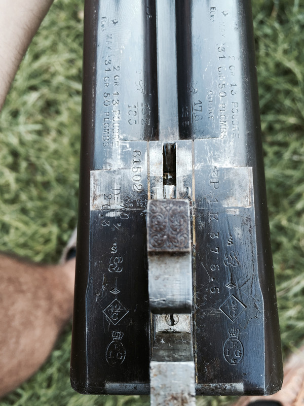

Does anyone know if a Belgium sxs made 1927-53 going to be nitro or Blake powder. It has 55mm (2-1/16) chambers so is their any load data that I could use. I did not see any on the Hodgdon site. I would think modern powder but chamber length ,and beings hammer gun has me worried.TIA

Full size close up in focus images of every mark on the barrel and action flats would help.
The lettre annale would document the exact DOM
I'm sorry but I've never heard of "Blake" powder, and could not find it on an internet search.
Does it carry Smokeless Powder proof?
Is the original Certificat d’epreuve no longer with the gun?
After the proof house revisions of 1924:
“The pressure developed, measured by crusher type device, lower or equal to 600 kg per square centimeter for sizes 16, l2, 10, 8 & 4; 670 kg per square inch for sizes 20, 24 and smaller.”
600 kg/cm2 = 8534 psi maximum SERVICE pressure;
670 kg/cm2 = 9530 psi maximum SERVICE pressure
+ 10 - 14% by piezoelectric transducer measurement
