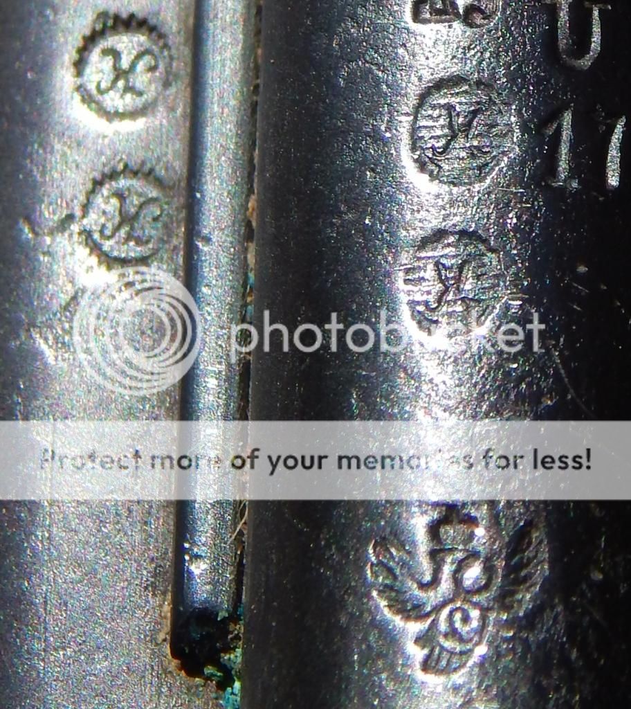

Many thanks Joe and my interest lies with the the script stylized K(or L) forward of the flats on the tubes.

Peter @ Tanner's Sports Centre was very accommodating & posted many more pic predicated on additional requests.
Subject Lindner - Daly w/ Script, Stylized L
Linder - Daly Nr. 768 on GI w/ Script, Stylized L
Both with a Script, Stylized L that very well could be for a Langenham mechanic although Gebrüder Lagguth & Gebrüder Luck are also contenders for the moment.
So in the 2nd series a L mechanic was heavily involved in tube work for the Lindner - Dalys.

[Linked Image from i697.photobucket.com]
Axel E. gives that the Crowned Imperial Eagle with a Script L in his talons is a Luck trademark.

Same Script-Stylized L on the forend hanger on a Sauer offering Nr. 61458:
