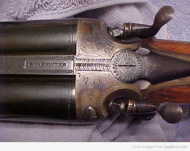

Mine is the 12 gauge Brescia with 30 inch barrels
Sure is fun to shoot.
Would love that same gun in 20 gauge with 30 inch barrels
