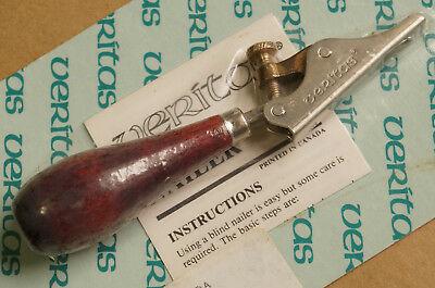

There is a specialized type of plane made that lifts a small curl of wood. Then a nail, screw or pin can be installed, and the curl of wood is glued back down, thus perfectly concealing the now hidden fastener
I read of that trick, but I never knew that there was a specialized plane for it, thanks for posting.
