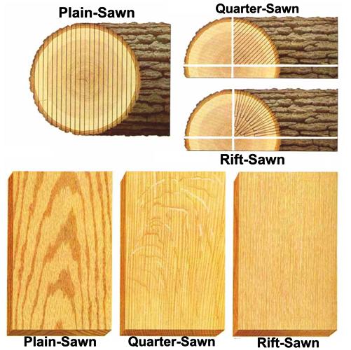

Slab sawn walnut generally shows more figure, but it is also more likely to be "one-sided" which means one side may show a lot more figure and grain than the other. Slab, or plain sawn wood is more likely to warp or cup.
Quarter sawn wood is more stable, and typically shows more similar figure and grain on both sides of a board or stock blank. Here's an illustration:
As you can see, there are going to be some boards in a plain sawn log that will have quarter sawn grain and figure because the growth rings are mainly perpendicular to the cut side.

Actually buzz, as you can see from the illustration I provided, rift sawn wood has a higher percentage of lumber with the growth rings nearly perpendicular to the face of the cut side. So it is actually more likely to have balanced figure than a lot of quarter sawn boards or blanks. But a true rift sawn log will yield less lumber and more waste than quarter or flat sawing.
No, true rift cut wood has the grow rings at 45 degrees to the blank, making it LEAST likely to be balanced.
You can get a lovely stock from rift cut wood but they are most often one sided when it comes to figure. Wonderful examples of wood cut in the 3 different style are shown at hunterbid.com

I don't have to try hard at all Queen Stevie, because I provided an illustration of rift sawing. A picture is worth a thousand of your incorrect words.
Speaking of incorrect words, "one sided" means that one side of a stock blank will show much more figure than the other. Rift sawn wood is more likely to be more evenly balanced in grain and figure than other cuts.

Your picture fails to accurately show end grain Billie keith( I will skip the childish gay name calling).

Well, that certainly is end grain. And that certainly is an angle guage that is being held against it.
However, the wood in the picture is obviously not rift sawn.
Saying it is rift sawn will not make it rift sawn.
