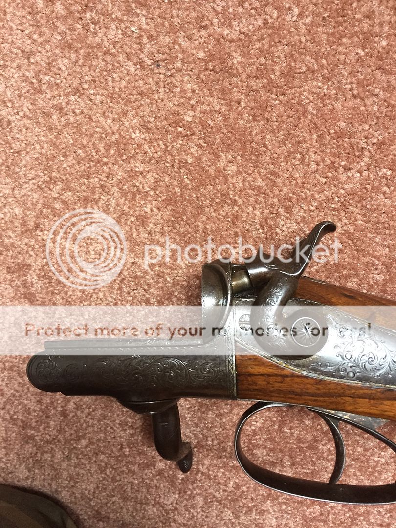

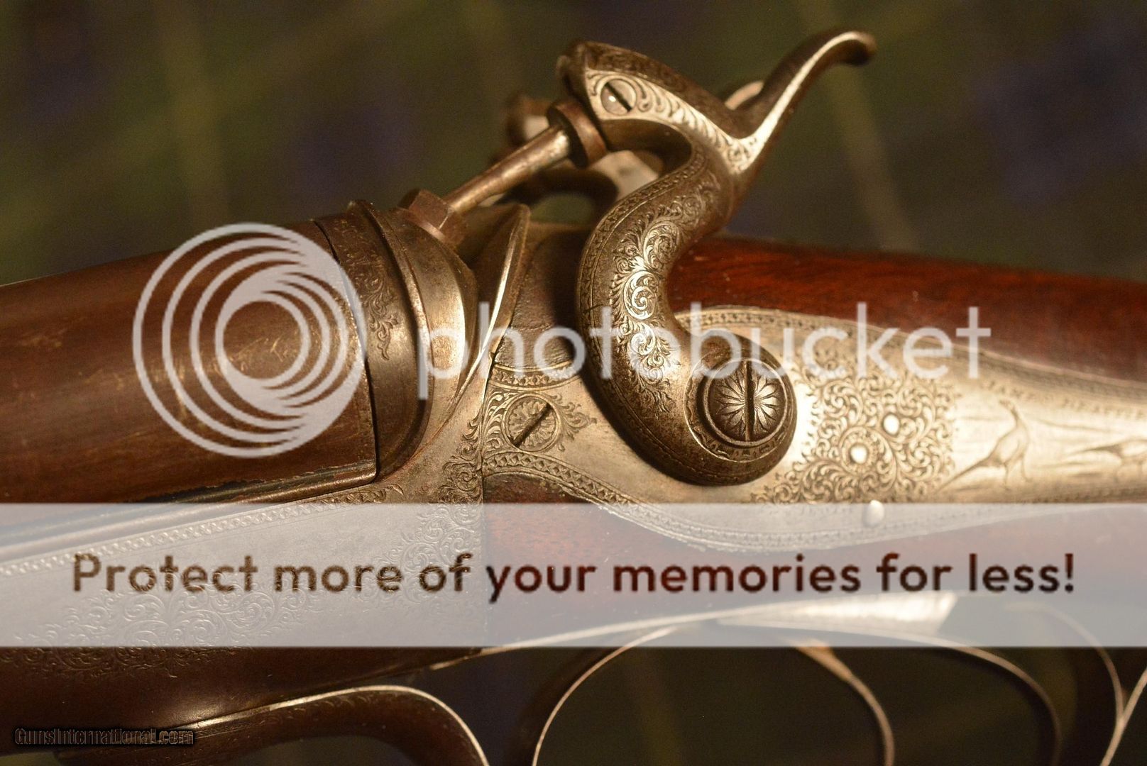

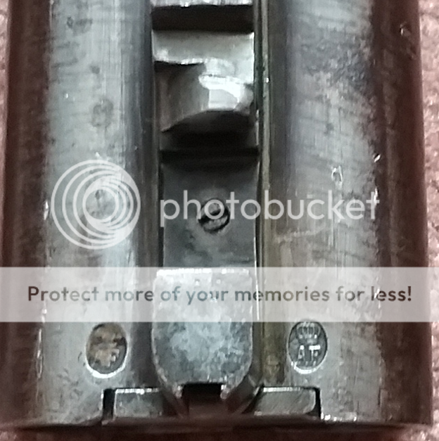

The lock type is of the back island variant with non-rebounding locks(John Stanton devised an advancement in 1867).
http://doublegunshop.com/forums/ubbthreads.php?ubb=showflat&Number=329313&page=1
https://www.gunsinternational.com/guns-f...un_id=101167800
Beattie w/ firing pins on the hammer faces.

The Alex. Henry and Adams in the first link are very similar to what I have except for the higher fences on mine. Will look up Stanton.

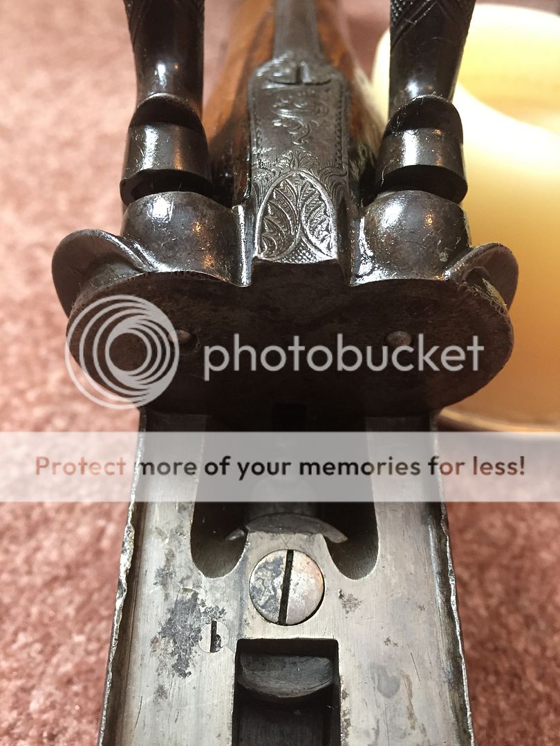

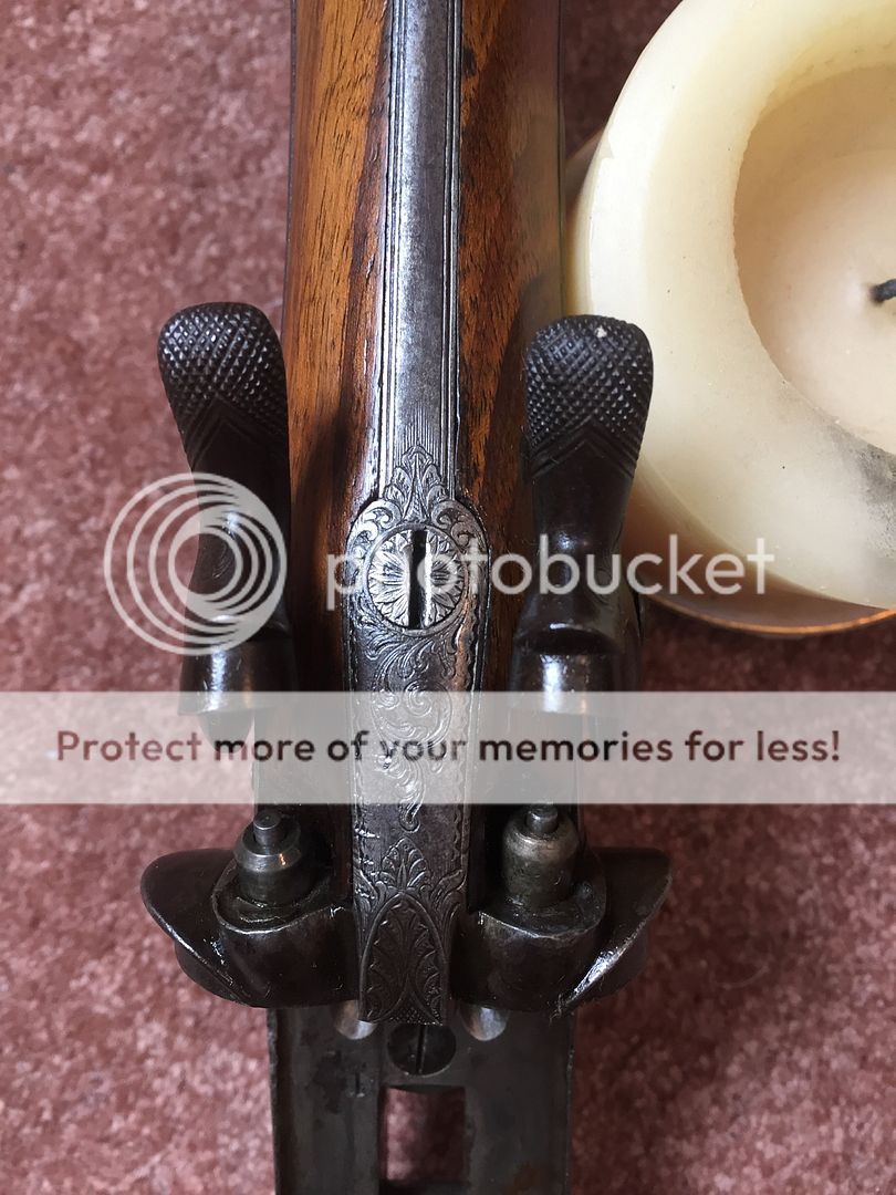

What about those set screws in each corner of the standing breech? Do they hold the strikers in place? I've seen conical fences/balls but those are quite odd. To mine eyes, it looks to be cast?

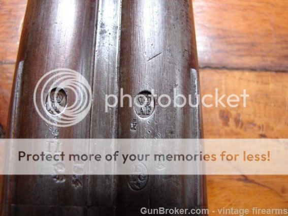

Check out the proof marks on this Francotte percussion gun:
https://www.gunbroker.com/item/807618690

Very interesting and some similarities in the barrels and striker locations, and the long tangs, forearm and butt plate. The locks are quite different though with main springs in front of the hammers. I was wondering how mine could be valued and this one seems high to me for what it is. I can now see your point about how this percussion's configuration could be converted to centerfire. Nice find, OWD.

Subject longarm - so the tubes were severed just past the AF trademark?

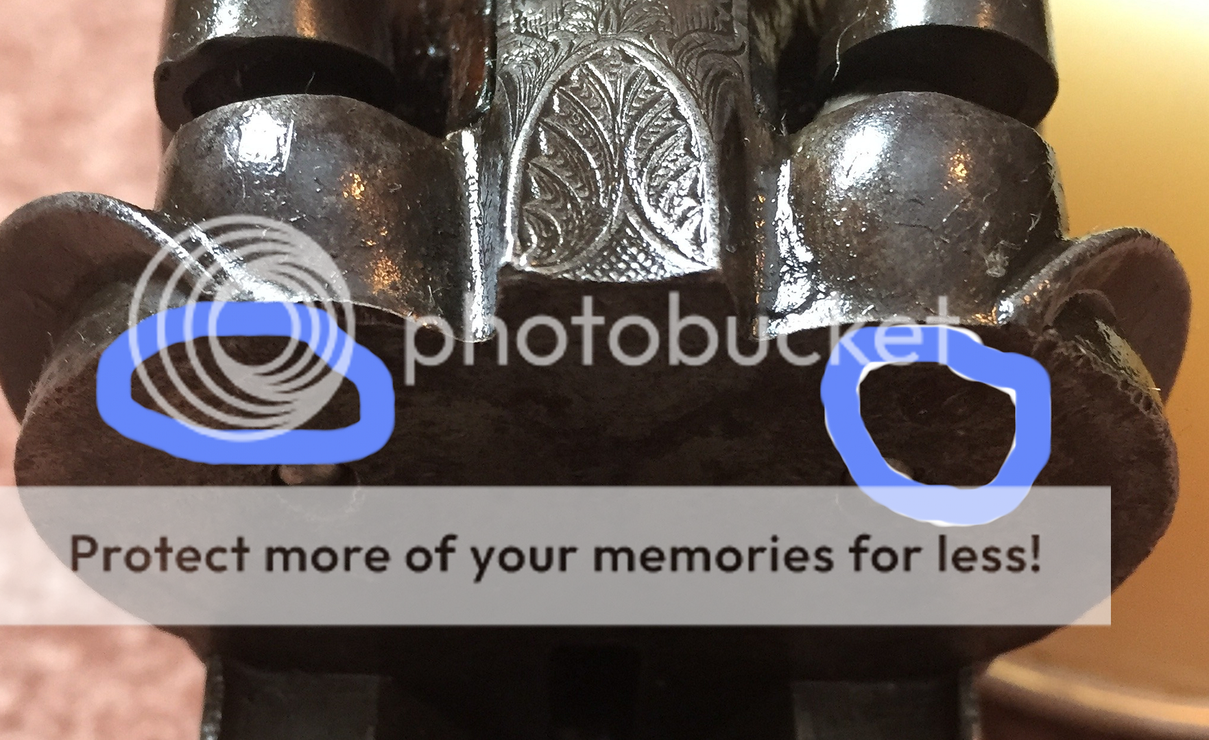

What about what looks to be these 2 screw heads?

Raimey, I noticed on the percussion barrel picture on gunbroker.com that OWD linked, there was a lip at the lower end of the muzzles that seemed to serve to hold the ramrod from slipping out. Is that unique to percussion barrels only. because there is such a reinforcement, not quite so pronounced on mine. It could also just be there to reinforce and bind the underside rib. I have an 1881 Parker underlever that does not have this reinforcment.

I took a close look with a magnifying glass and the right side does have a circular impression, but it does not appear to be a screw. The left side doesn't show the same circular mark.
