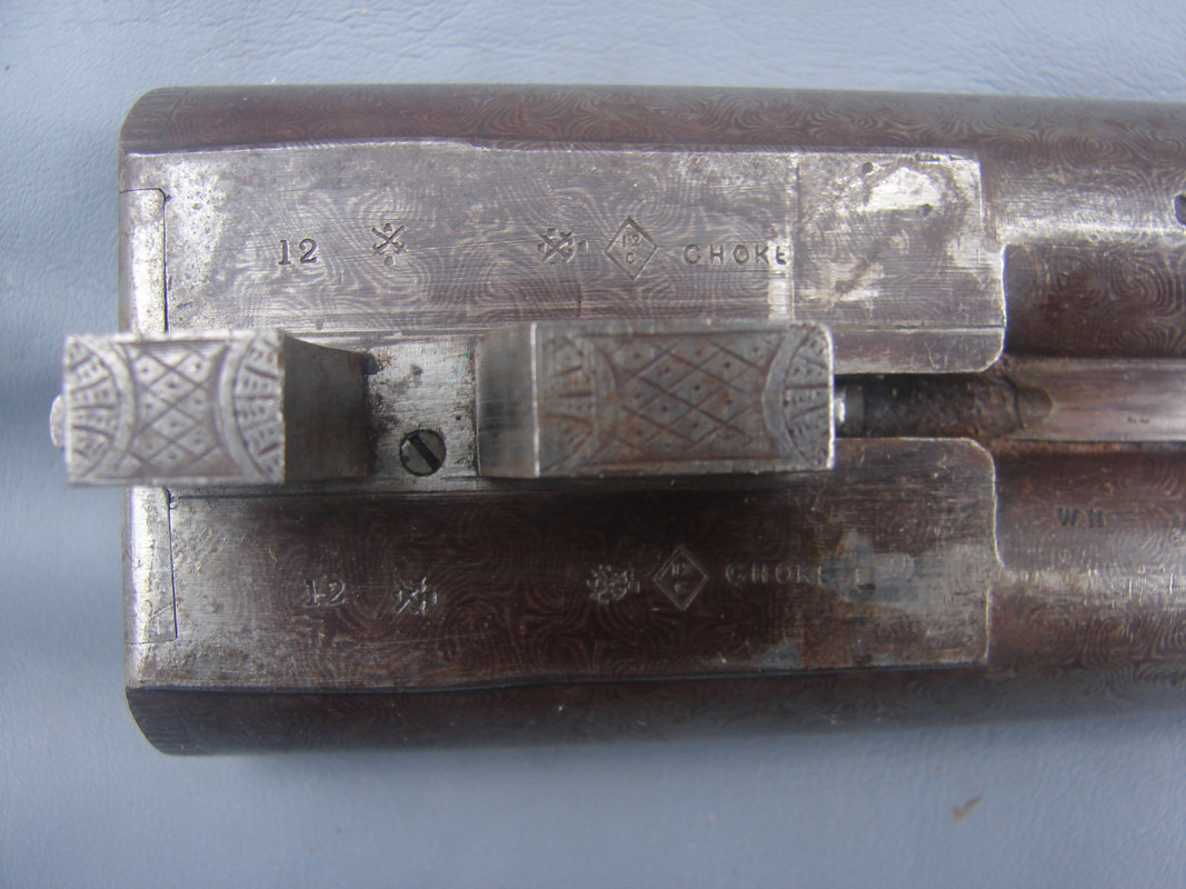

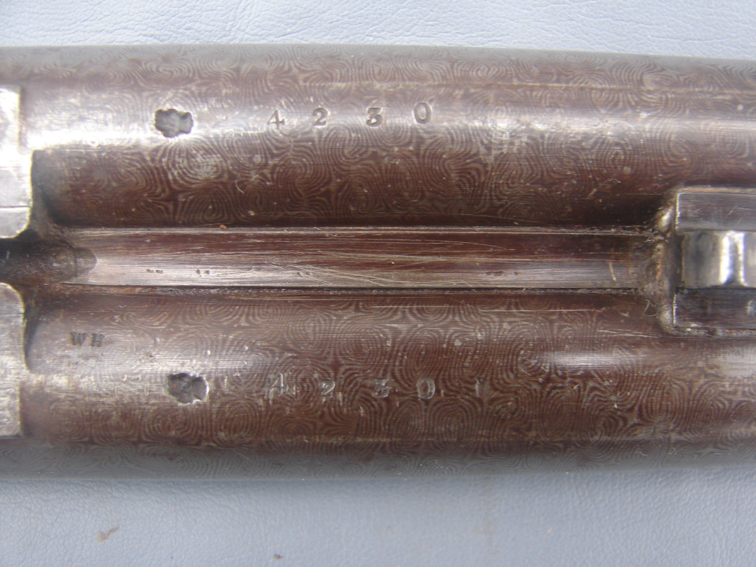

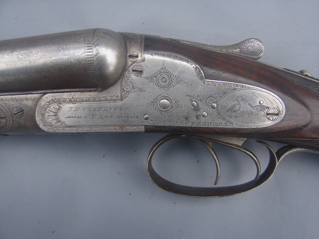

I finally made some pictures of the Clabrough, 11 actually. Will split them into two posts for easier handling.

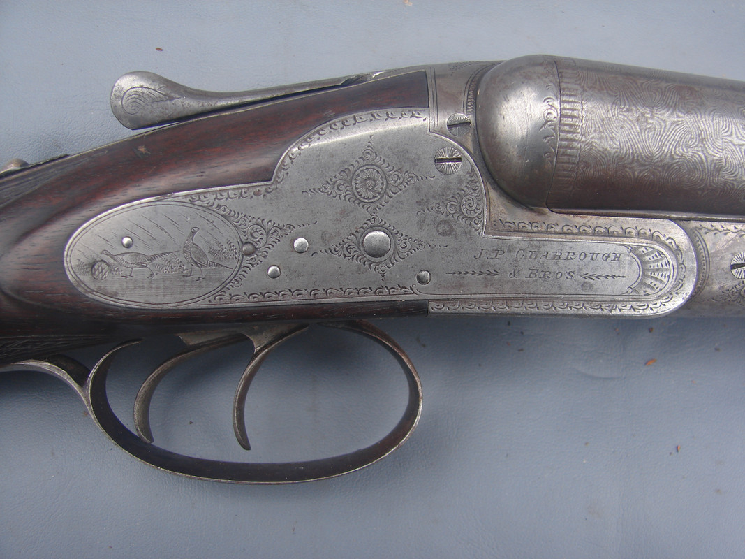

Left Lockplate
Right Lockplate

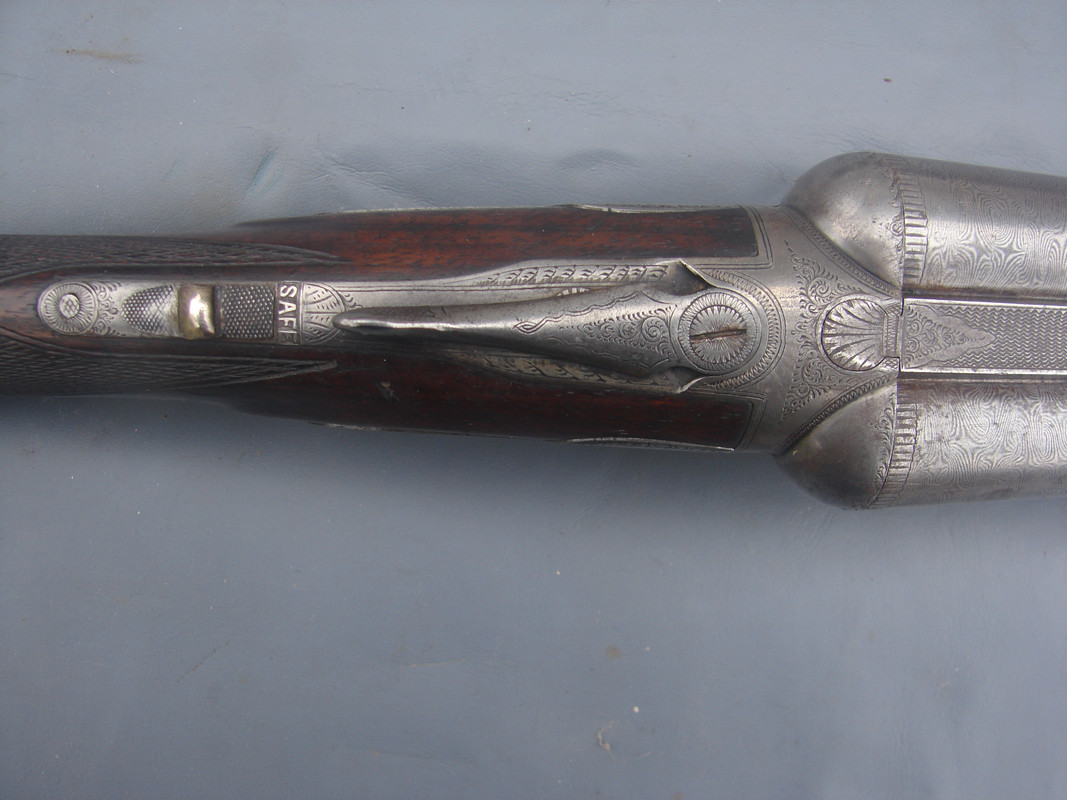

Action Top

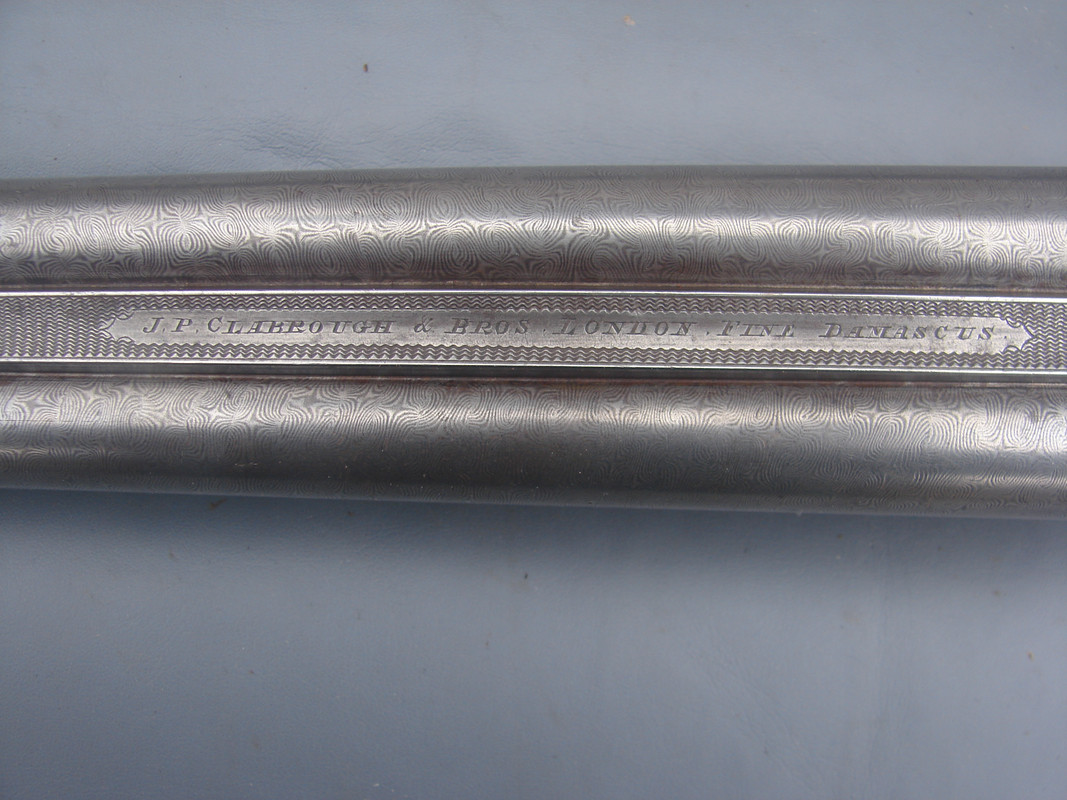

Rib Marking
Barrel Flats
Barrel Marks
Anyone know who the WH is, Assume perhaps the Barrelmaker.

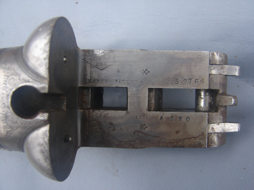

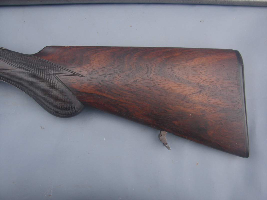

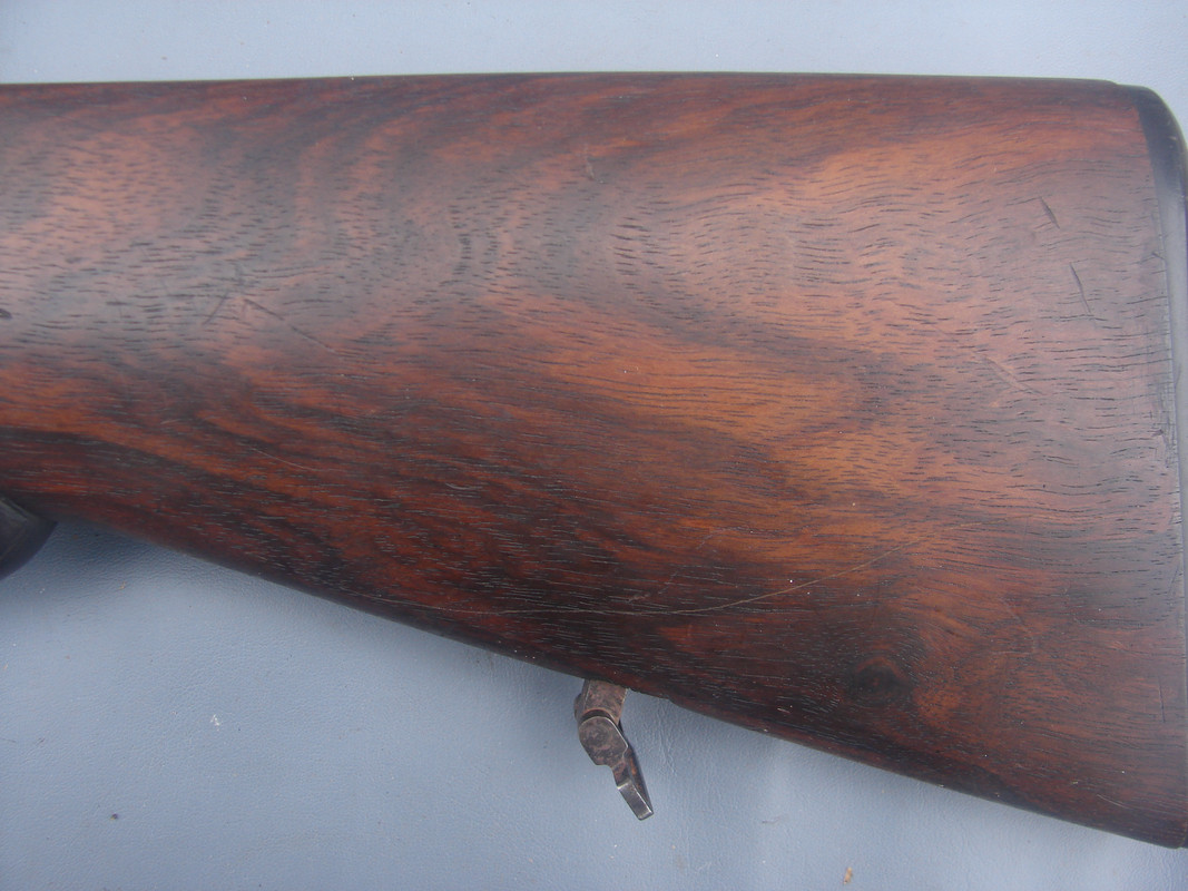

Here's the next Batch;
Action Flats
what does a forensic anthropologist do on a daily basis
Patent Marks
Stock
Stock Closeup & Rear Sling Swivel

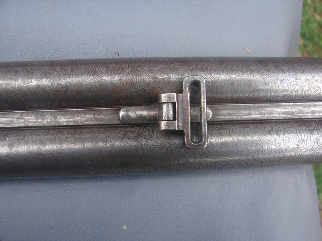

Lower Barrel Rib & front Sling Swivel
Miller/TN
