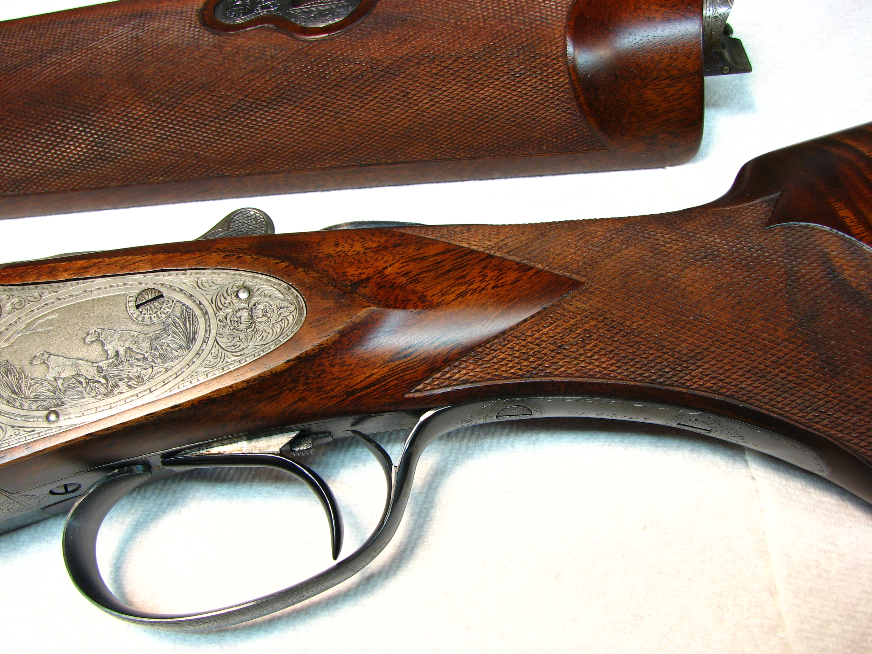

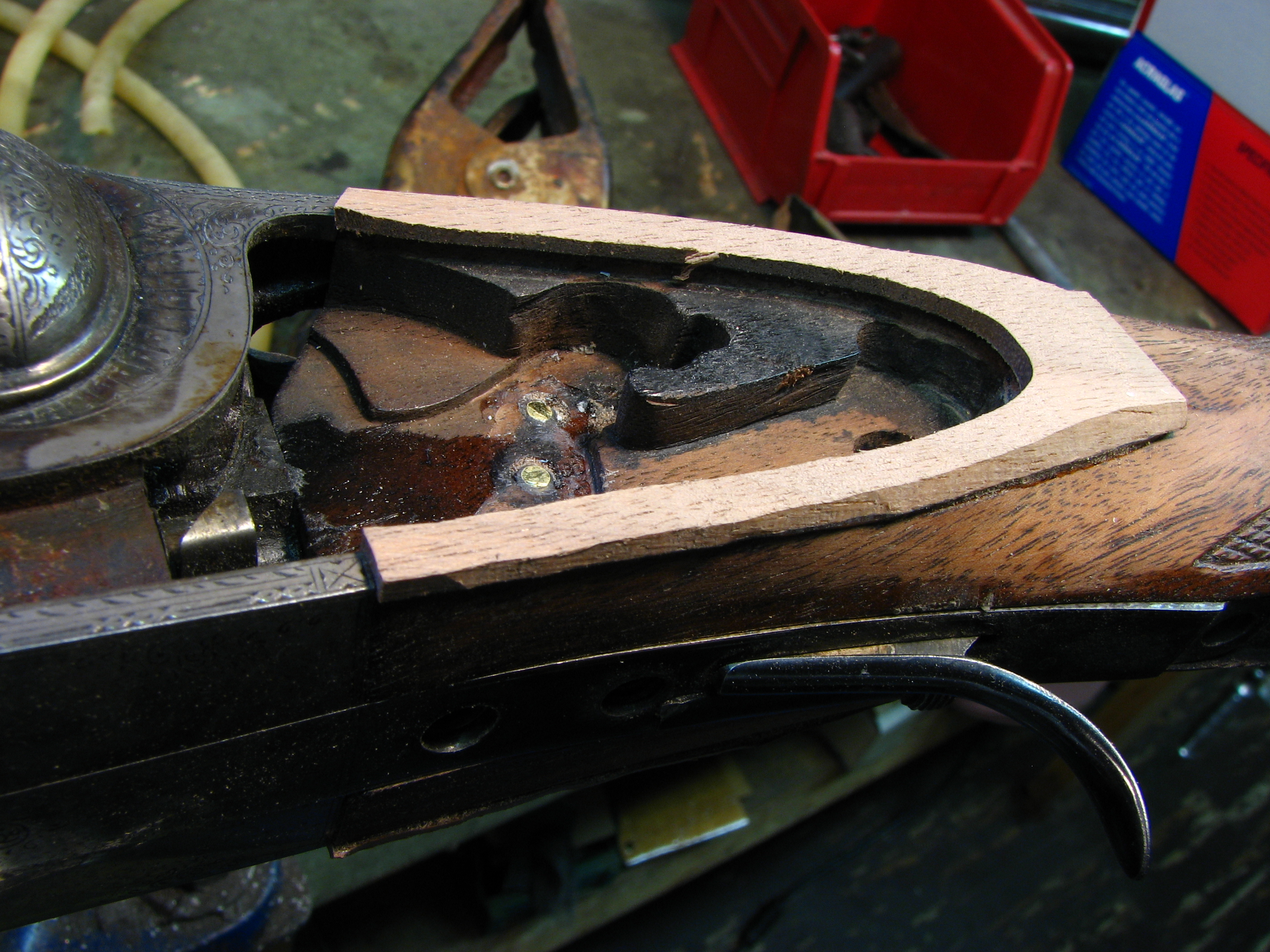

I am hoping someone has seen this picture online and can point me in the right direction....I came across a picture of an L.C. Smith stock that had the cracks and chips behind the side locks. The gentleman planed down or sanded about an 1/8" of the wood around the sidelock out to the point. He then took a piece of wood that was close in grain and glued it to the stock. He then had to inlet the sidelocks and blend the patch to a point but it was nearly undetectable. I have looked for a week now but can not find that image. If anyone has seen this and can point me in the right direction I would greatly appreciate it. Thanks in advance.

Thank you guys, those were the exact photos I was looking for!

Seeing how its done helps but his skill level is at the very highest. If you dont know what to look for you just dont see it. Unlike the other job which looks like it was done with a weed wacker and can be seen ten feet away as a bad job. But done right cost money. Its just nice to know where and who to send stuff to.
