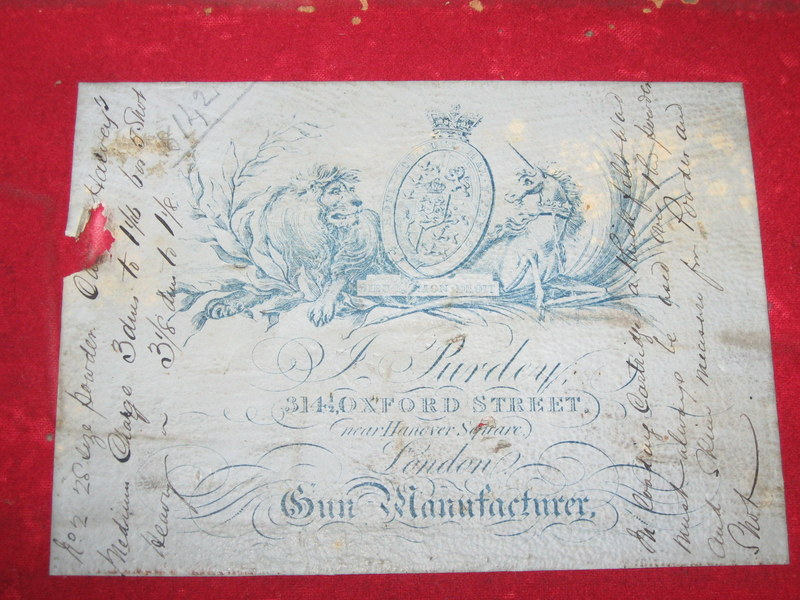

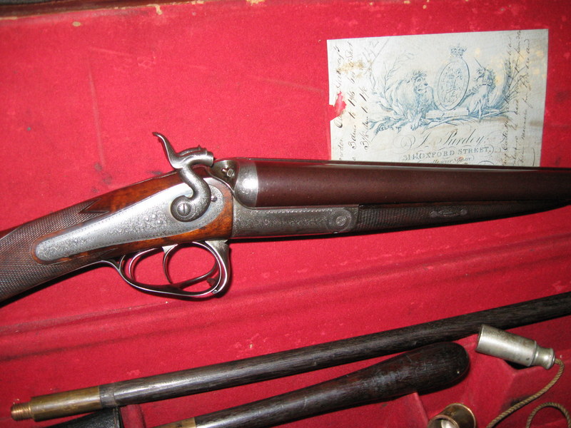

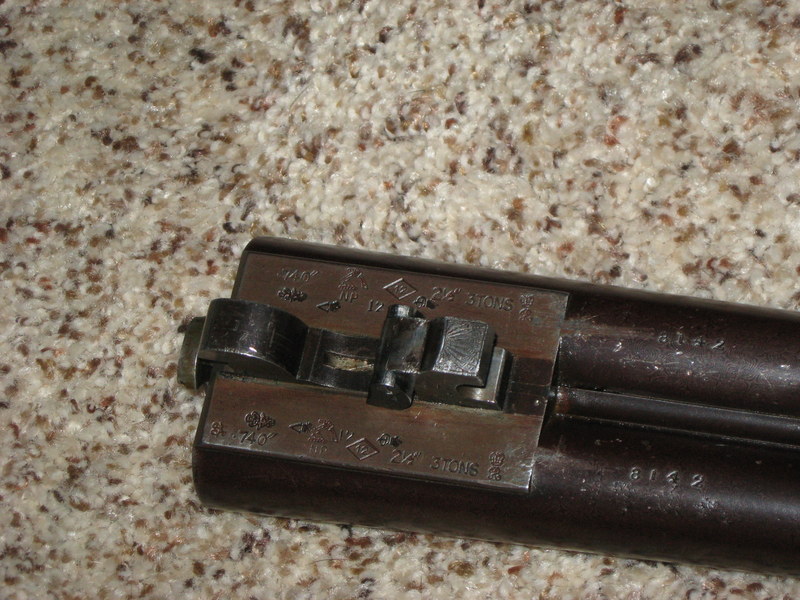

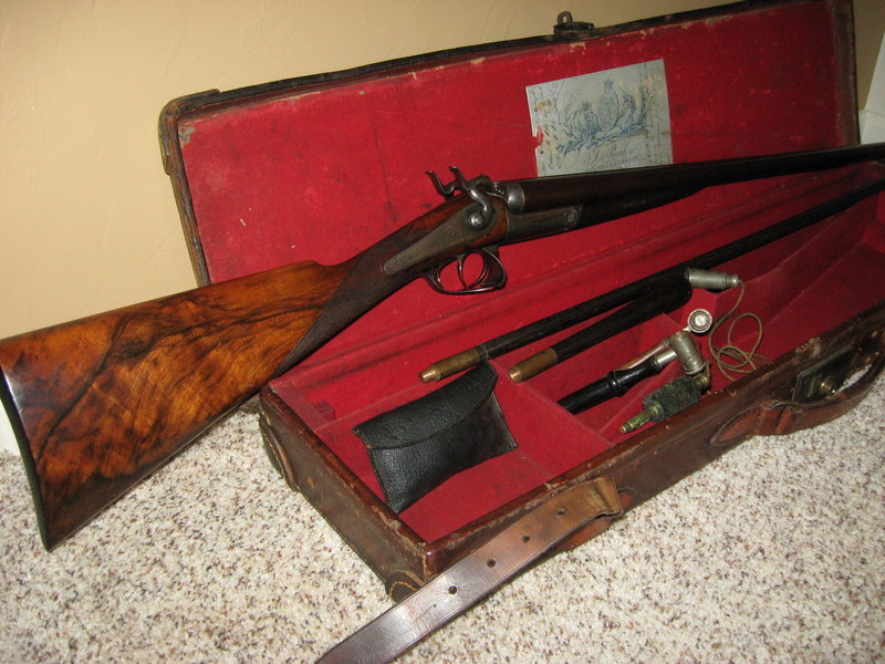

Thanks a lot for the photos. They inspired a lot of thoughts. My research so far indicates the Purdey barrel marks normally appear on the barrel flats in front of the hook like your pictures show. A "JP" indicates the barrels were finished by Purdey. Other letters denote other people finished the barrels. Other barrels not finished by Purdey were rare in 1869 when my gun was built. As I am finding out nothing is that straight forward on old Purdey guns. My gun has no marks-see photos below. I contacted Donald Dallas about this and he said no marks were not usual. The barrel marks denote who finished the barrels-not who made the damascus forgings. Purdey got their damascus forgings from the best suppliers available-usually from England and most likely Belgium. I sent a few pictures of my gun with its original case with the Purdey label marked 8142-the gun serial number. As far as I know all the major parts are original. I'll know more about what modifications have been made over time when I receive the original build specs from Purdey. As someone responded to my post the real fun is learning what you can about these old masterpieces! The search continues! Thanks to everyone who responded to this past! In the case a powder measure, an adjustable shot measure, original cleaning rod and a bore bush with rope were included. Sorry no pictures. I'll try to figure out how to attach pictures.
Bob

What is the 81 16 on the flats?

Kathy1 A nice Island locks back action version with a re-proof at .740 things cant get any better. The 81 and 16 stamps on the barrels a consensus of opinion on this it is some form of barrel makers identification because there where four guns ordered in this set so it could stand to reason that some form of identification may have been needed for the number of tubes or completed barrels. Though I am always open to suggestions to some other reason for these numbers, I would dearly like to find another gun from this set made for Henry Chaplin just to compare but I have never found another owner to date.

The only reason I ask, is that I have a Birmingham gun that has 80 25 stamped on each sides of the action flats (80 on one and 25 on the other side) I assumed it was done at proof as the gun was reproofed and left little to no room for any other stampings.

Let me suggest another idea! My gun was re-proofed in London in 1980. I know this because a date code LP over 80 is stamped near the breech on the lower barrel in my picture(you probably can't see it in my picture but it's there). My proof chart tells me your gun was re-proofed between 1954 and 1985. Maybe the 80 is a date code for re-proof. Date codes at the Birmingham proof house were on and off and always very confusing. The 25 may be the identity number for the employee who did the re-proof. Just a thought!
