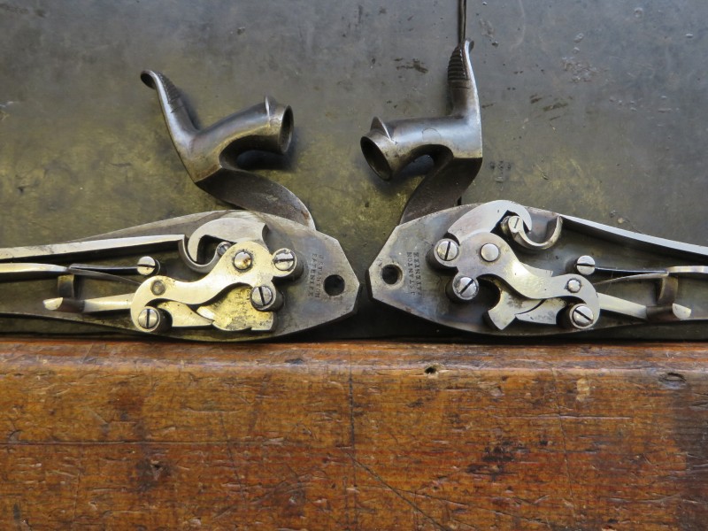

John Dickson , conversion with rebounding locks. It is marked Brazier Patent, but I don't know exactly what the patent was for, or by which Brazier the Patent was registered.

Stanton locks;interior faces are seen on plate 49 in the book Game Guns and rifles ,by Richard Akehurst, The illustration show examples of Stanton rebounding locks, patent 367 of 1867 and the improved version patent 3774 of 1869.
Similar illustration s are seen in Vol;1 page 202 of The British Shotgun Vol 1 by Baker and Crudgington.

A bit OT but it is interesting to note that the main purpose of the 2nd (1869) Stanton rebounding patent is often missed. If you look at the picture below, in a conversion from non-rebounding you will see that the sear spring would have to be sacrificed or moved to use the bottom arm of the main string to power the rebounding effect. The use of the patented main spring gets round this problem. Quite why it was used on the bar-lock pictured in The British Shotgun is beyond me other than the possibility it was specified in order to have the 'best and latest'!
