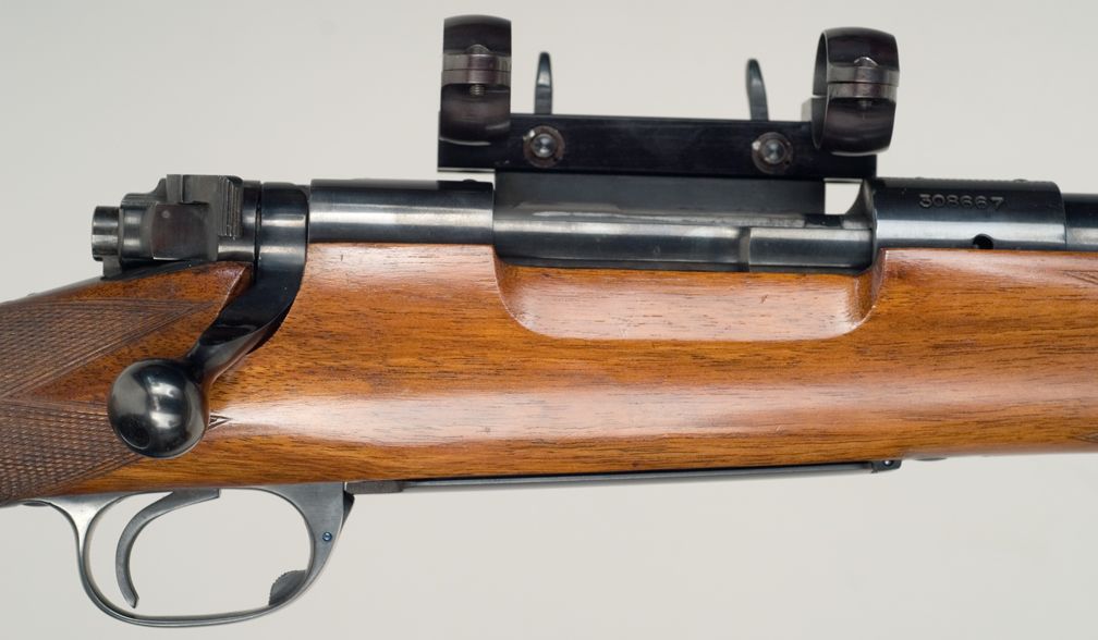

Nick,
1960's, G&H, M-70 (the only bolt handle pic I have)
