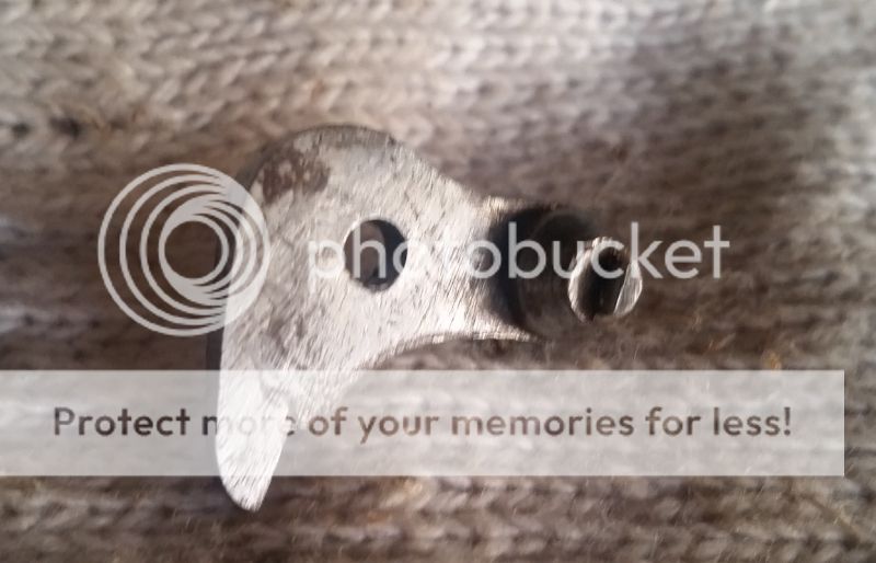

The above extractor link is from my Stevens 235 project gun. I don't have a good one to compare but I'm thinking the now half-moon shape of the button that rides in the frame was once full round. The link slips out of the mortise in the frame and the barrels fall full open without the extractor being lifted.
I can't locate a replacement. Is there a way to refurbish this one?
It looks like the part could be an assembly of the basic flat piece, two cone shaped parts and a pin.

There are many options for this repair.
First, prove that the half moon part is broken or worn off.
If it is, you could have it welded and filed round again.
Or, filed flat, a hole drilled, and a new shaft sweated in, and then filed to length.
It just depends on what facilities and abilities you have, and how you wish to proceed.
Always easier to spend an afternoon calling around to old gun junk yards for the part.
Maybe start on a Savage forum locating parts repositories.

Well,,mines a Model 335,,but the link looks about the same.
Heres a few pics.
The end of the 'pin' is full round, not half round.
It does look like an assembly of the flat lin k,,two cone shaped pieces and the pin itself.
The pin in mine is slightly 'off', being outboard a bit farther on one side than the other. I suspect it's just a force fit (hammer) and that keeps all the pieces in place. The geometry of the cone shapes and the forces pushing inward keeps the assembly together during use.
Try knocking it apart and replacing the pin with a new one.. Otherwise file off the end and drill it out for a new pin as suggested. A press fit, soft solder or even loctite shold be sufficient to hold the assembly together for whats expected of it.

The link is made up of 4 parts, at least now it's in 4 parts. The center pin did punch out but with a lot of resistance. One side didn't want to move so I drilled it out. The pin was reasonably soft. I'll make a new pin from a sacrificial drill and maybe use red loctite.

I got the link repaired. I happened to have a 16d nail on the work bench that slipped through the hole in the link with just a little clearance. The holes in the two cones are tapered. I'm guessing the factory pressed them onto the pin. I put the pin in my small lathe and put a slight taper on each end with a file until the cone would be well started but tight on the pin. I ended up securing the assembly with green Loctite.
The fitting process drove me nuts. Not understanding exactly the relationship and action of the link wasted a lot of time. I had made the new pin a litte long on purpose. This was my downfall. The link wouldn't drop far enough into the frame to slide under the ledge. The mortise in the frame is tapered. Just a few thousands and it dropped into place and did it's job.
