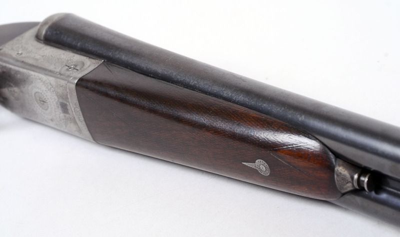

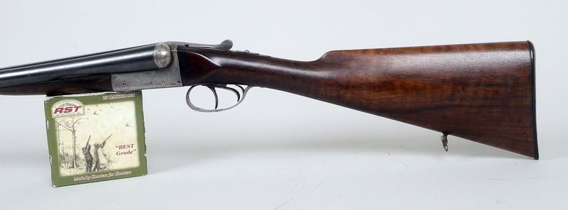

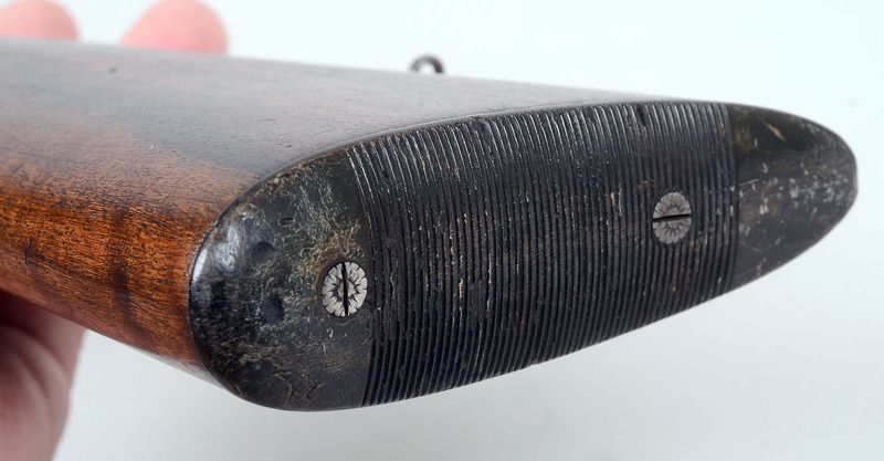

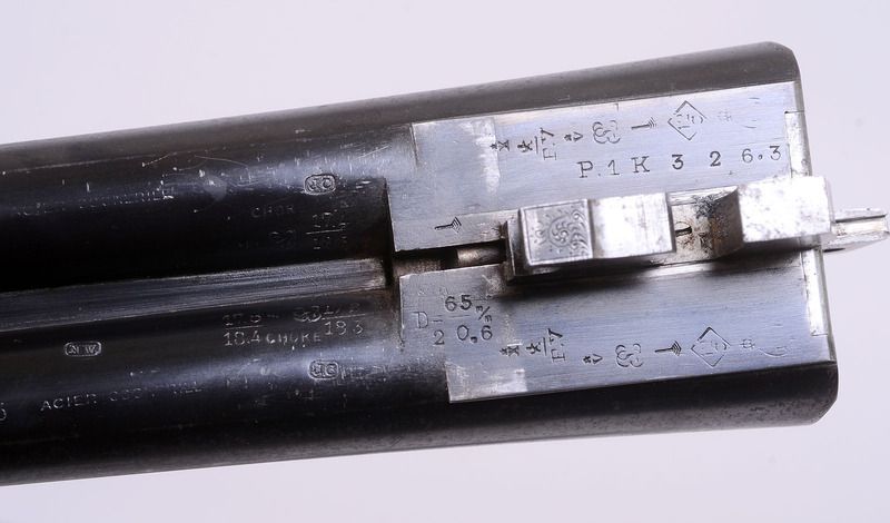

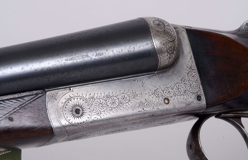

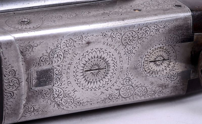

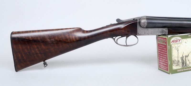

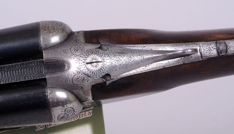

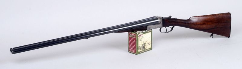

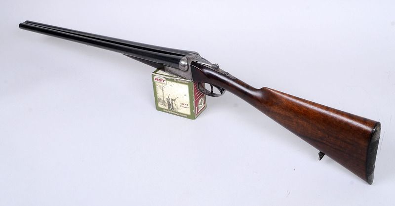

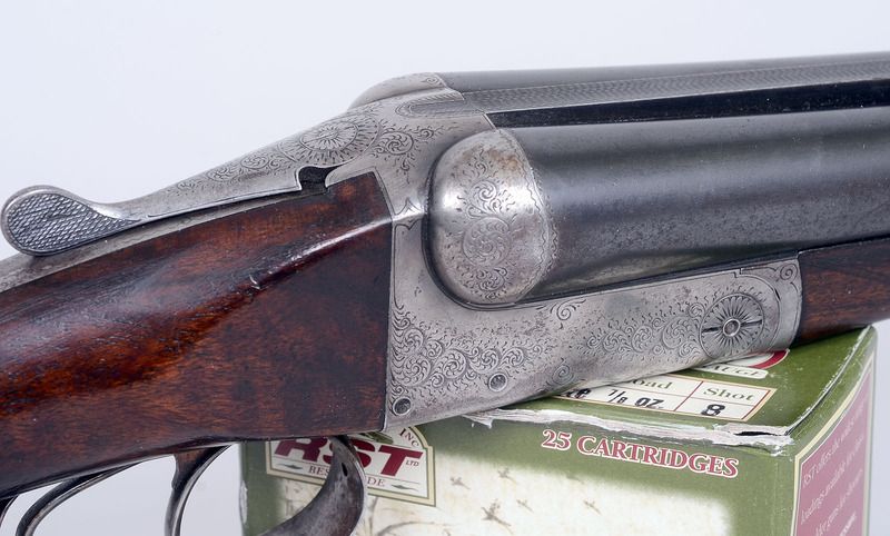

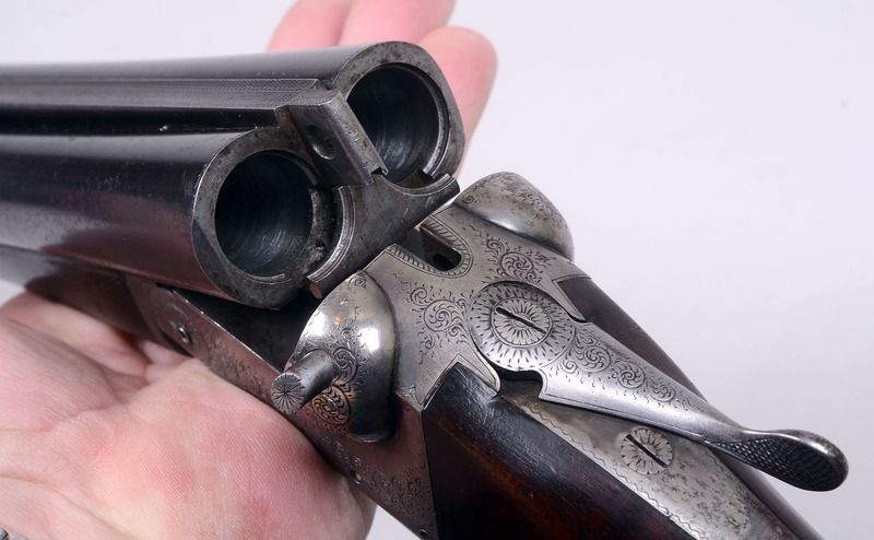

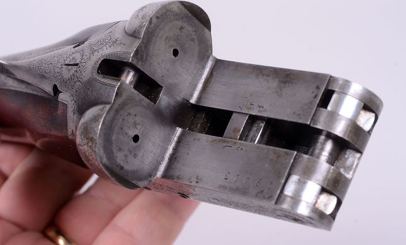

I believe it is a Belgian-made 12 gauge, probably made for a French shop/gun seller. Cockreil tubes. 65mm chambers. Somebody has removed the checkering, presumably in an ill-fated refinish attempt. Any thing you guys can add to my knowledge is appreciated.

Medium quality Belgian made gun for French retailer.
Belgian proofs seemingly mostly struck off. Begs a question.
I'd closely check barrel fitment.
Not much collector value, good shooters. Plenty around.
FWIW, I id them like ducks for origin.
The first thing that pops out to me.
Inverted pin ends almost always are Belgian in origin.

An old Dutreuil thread on Shotgun World
http://shotgunworld.com/bbs/viewtopic.php?f=5&t=429133
and here
http://www.doublegunshop.com/forums/ubbt...e6172d7d6ab57c4
It was made 1910 - 1922 (no lettre annale) and does carry smokeless proof.
With the 2 muzzle constriction over bore markings on the right (only?) barrel it may have been reproved after honing
'JC' could be Joseph Cap
http://www.littlegun.be/arme%20belge/artisans%20identifies%20c/a%20cap%20joseph%20gb.htm
PeteMs list does not have a 'NW'

Chambers still 2 1/2"? Sometimes they seem to "grow" without the appropriate reproof.
French gunshops, although they had their own quite active industry, often seem to have marketed Belgian-made guns.
Joined: Jun 2012
Posts: 177
Joined: Jun 2012
Posts: 177
Funny how that happens . . .
These have been lengthened. I shoot RST shells in it, though.

End of chamber and forcing cone wall thicknesses are critical.
If the bores are not 18.4 = 0.724 it's been honed some more frown
What could possibly go wrong? . . .

Henri Dutreuil ŕ Vitry-Le Francois - Arquebusier
I concur on the JC initials but what about NW: Nicolas Warrant, N. Wilmont??? I can't say that such a mechanic existed.
Probably nothing . . . unless the gun lost too much wall thickness as a result of the honing. But even with the lengthened chambers, better to stick with either 2 1/2", or else 2 3/4" hulls reloaded to low pressure.
