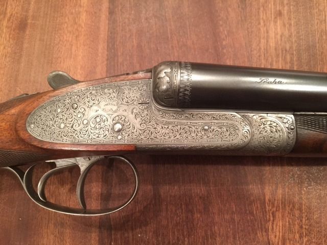

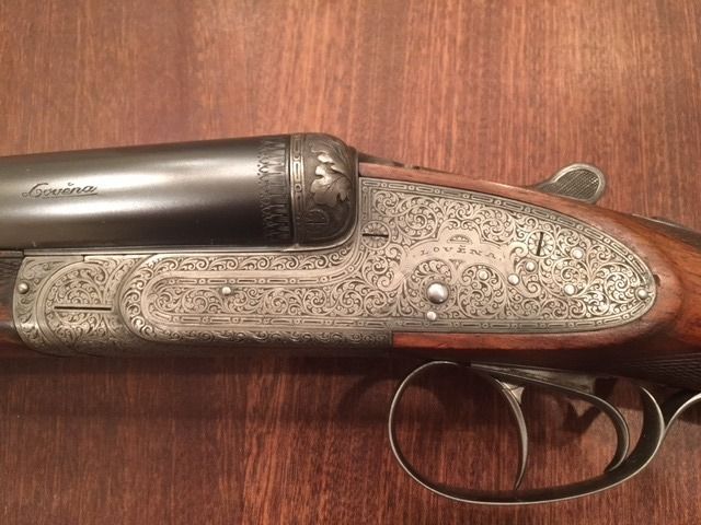

I picked up a beautiful old Belgian sidelock with engraving that reminds me of an H&H Royal. The frame and lock plates are a dull and dark gray. Is it OK to brighten it up a little with Flitz polish or Never Dull, or is this a mistake that would ruin the value? Thanks!

Hi RAS...NO...I wouldn't touch it with anything abrasive myself....do you have access to an ultra sonic cleaner?, think thats`what they are called .Take the wood of and clean locks n action in one.That will clean any grime off from the metal & in the engraving , but leave the patina.
But wait for more informed info than mine before proceeding with caution...

Totally agree with Franc. Nothing looks worse than polished metal on a vintage gun. Let it be what it is--a relic from the past that has earned a little patina.

I remember Abe Chaber doing the sonic tank job on the locks n action of a rather nice belgian sle I have,which I bought after he checked it out & gave me the thumbs up.
Then he gave it the sonic vibe bath...sounds sexy...?
It was amazing how much lovely faded colour came up..even the grey/silver looked so really clean, not polished looking
well worth a try, imho

Any chance it was a French gray finish?

[img:left] [/img]
Finally figured it out
GORGEOUS gun, please leave as it
