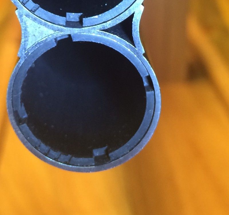

HELP!!!
Fairly new Citori.. Just notice the missing solder/filler...
What can I do?
Rib isnt loose. Not separated..

Just stuff a little wad of steel wool into the hole and fill it up with 50/50 solder. This time, clean and flux it so it won't fall out again. Once it cools, file it flush and polish it with worn 320 grit cloth, backed up by a file. Don't let the solder flow into the joint between the choke and barrel( maybe clay or tape).

No uncommon . Either fill it with solder , solder/glue a triangular fitted plug in . I have noted some guns have the nose ends have been filled with an epoxy type cold casting repair or liquid metal that frequently disappears during blacking . Altrenatly remove the plug on the other side and leave the nose ends open as it is mainly cosmetic .

There was no way I was leaving that open.... smile
Thank You guys for the help....
I used an epoxy putty by JB weld... I was told to closely inspect the side that was still intact,,and I would find it is a steel embedded epoxy.... sure enough it was....
Again... Thank you guys.. I thought i was in trouble..
