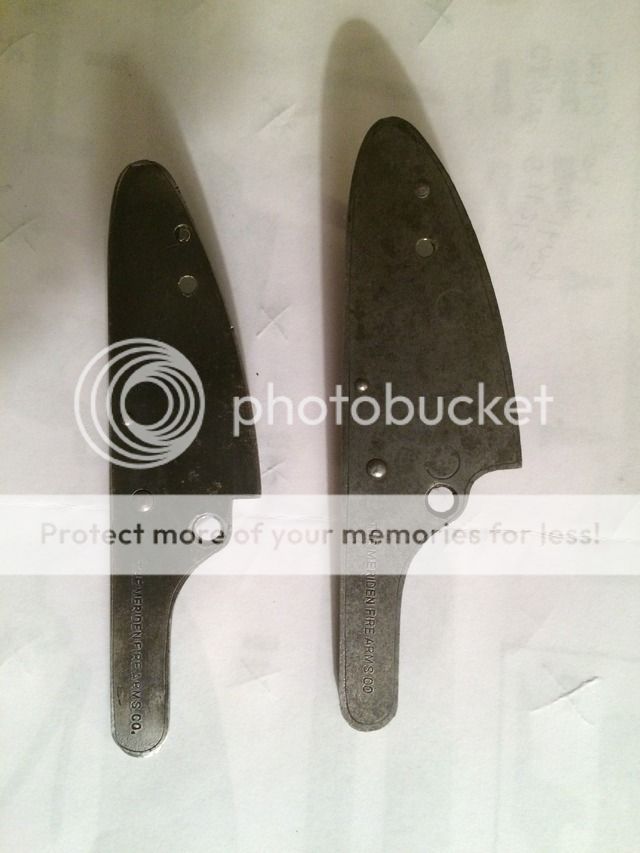

By across the faces I assume you mean through the centerline of the pins? If so, that is 2.02" and the pins are 1" on center. The side plate measures 1.13" x 4.5". Here's a picture compared to the 12 ga I bought which is .17" taller (or wider in this pic).

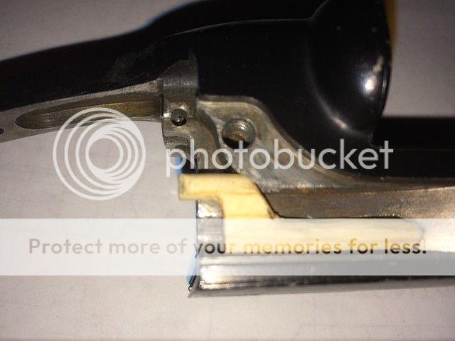

Here's a picture of the receiver with a mock up of the cocking rod. Looks like the rod for the 12 is .1" taller.
Not sure what I'll do. One thing it seems is that there were very few 20s made.

My earlier question on measurement was for the width across the frame/watertable flats. From your picture of the two sideplates it is apparent that the 20ga is reduced in height but I cannot determine if it is scaled down in all dimensions. Are the mounting screw and bridle pin locations positioned axactly as the 12ga plate?

In the end you may be left to reverse engineering the parts from the frame dimensions. I have an idea on how to modify 12ga cocking rods to work, if the 12ga. "rod" section forward of the offset is the same diameter as your 20ga. frame.
