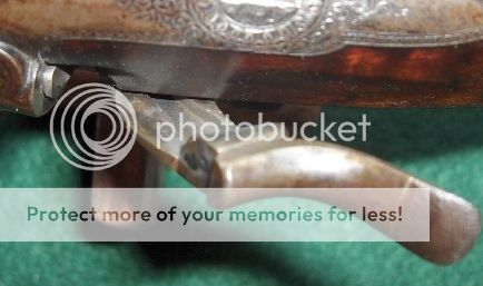

This is the 1872ish W.R.Pape that Santa brought me.
Can't wait until the weather is good to bust some clays or etc.
Pre 1954 2 1/2 inch Nitro Proofs and bbls have been seamlessly and invisibly sleeved.
Note the thumb push lever under the action to open it

The hammers retract the firing pins

Very nice! I do like the Pape guns and rifles. I do wonder why he built so many using the thumb lever opener? It is nifty and fine for a walk up outing or Red stag stalking but not to handy for driven shooting. I used a 500 bpe and found it really nice shooting once my thumb stopped looking for the top lever. Great fun on the clays course!

Beautiful. I have the same 1872 gun (SN 2145). Like yours mine has the little round extension from the extractors which slides in a groove at the back of the slot for the doll's head, literally extracting (pulling) the spent shells, rather than pushing the extractors with rods from the front. Do your hammers have grooves on the inside of the hammer to retract the firing pins? Another Pape invention. Mine is more austere in its ornamentation. Here is a shot:
