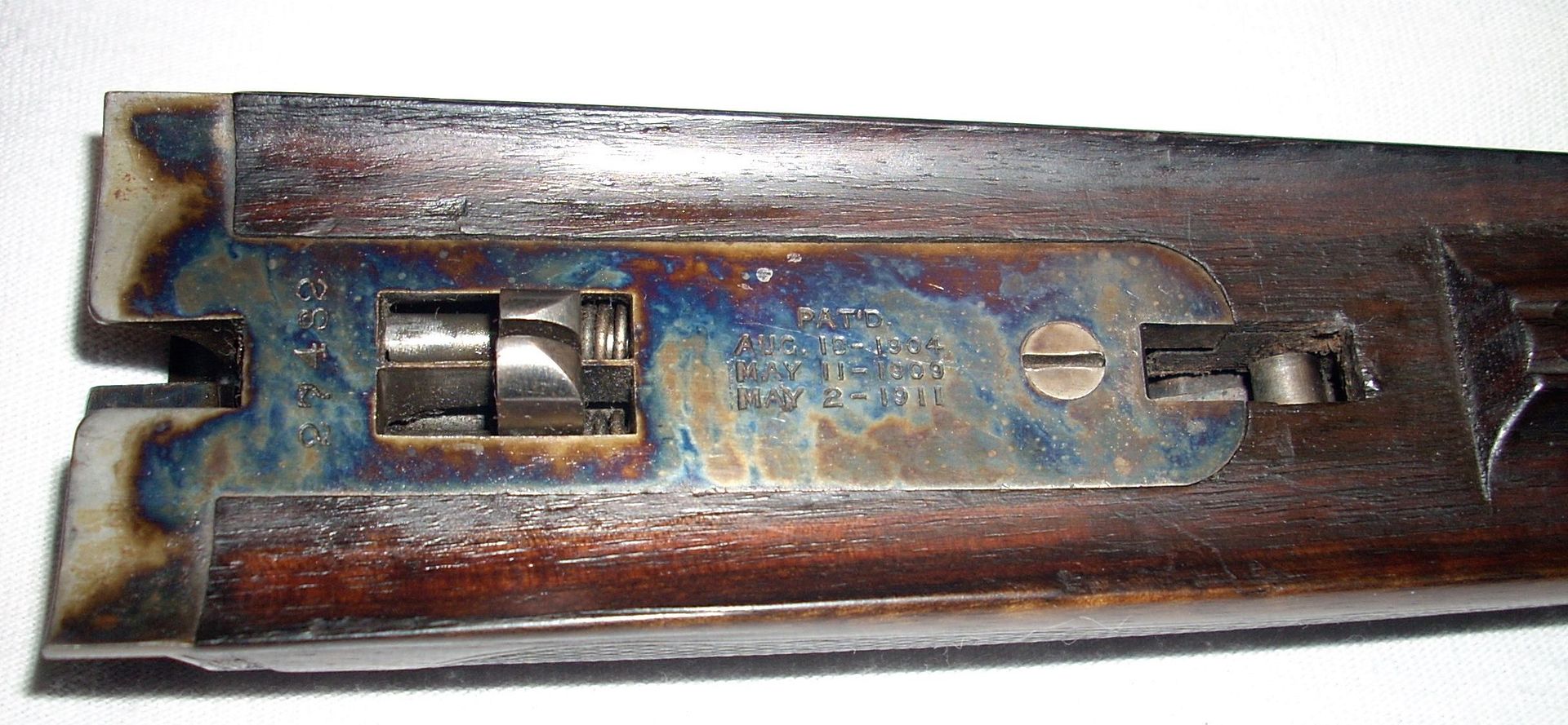

There are other superficial coloring techniques out there, many are listed in Vintage gunsmithing books, as well as metalworking manuals. This may be one of them.
Posts: 76
Posts: 76

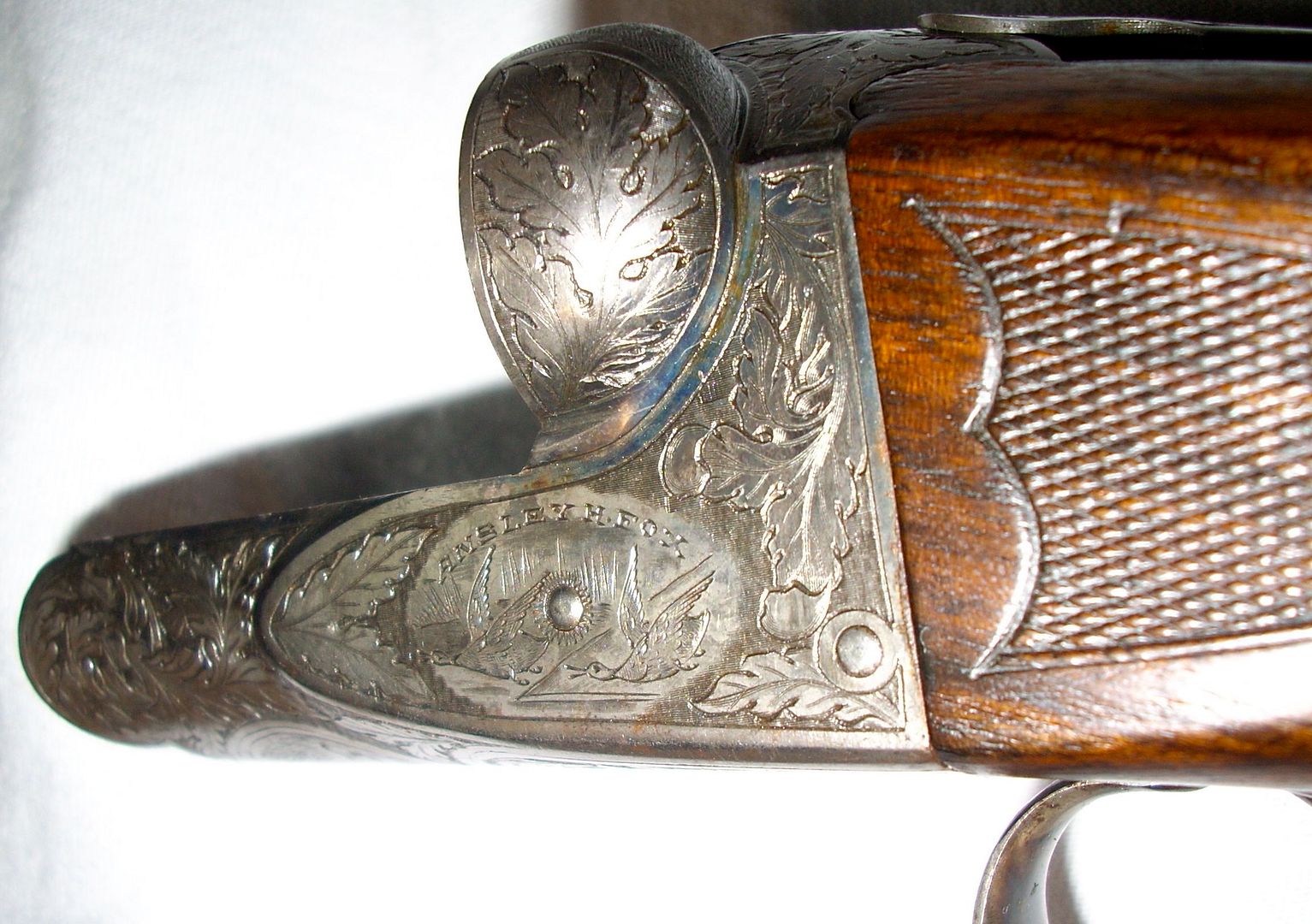

I don't know, I think they might be original. Here are 2 poor pics of my 1921 XE, very little color left on the receiver but I'm seeing some of the same hues as the original post.
The only solid color on mine was the fore end iron.
