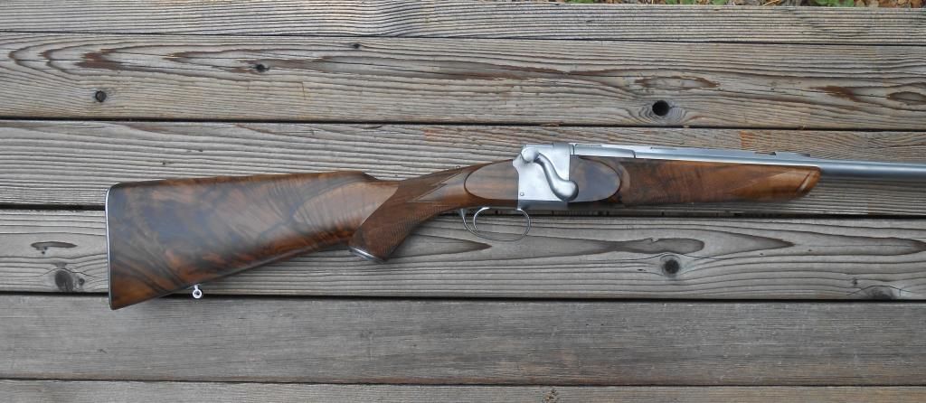

This a view of the Steve Earle Fraser action. The top of the side lever rotates back slightly to unlock the lever. The lever can then be rotated down. This is a wonderful action to build a single shot sporting rifle on.
Doug Mann

Doug - may I ask if we might see some more pictures of this rifle

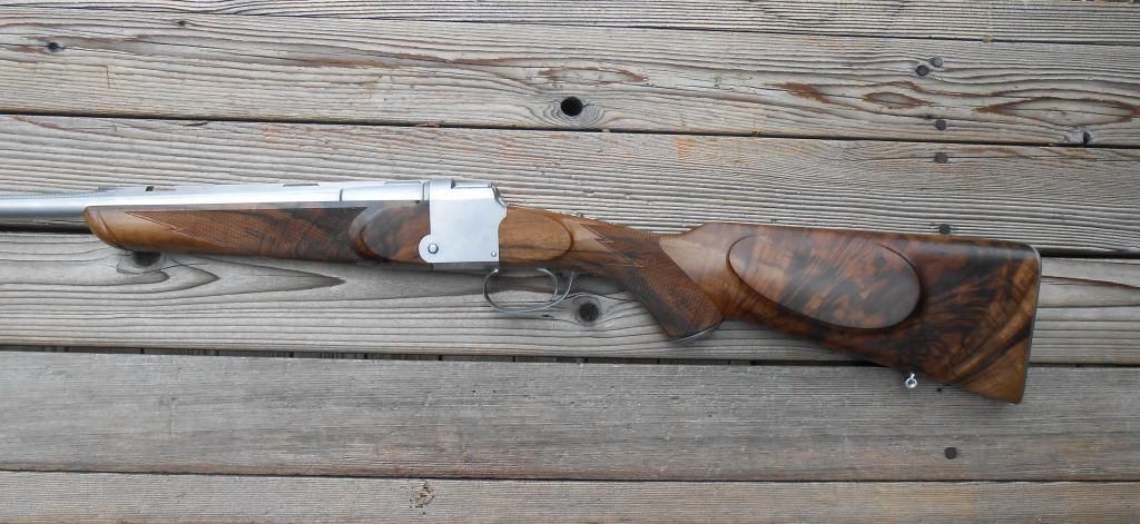

Tentman, I'll post a couple of side views of the rifle. Please excuse the photography it not my strong suite. This is my personal rifle chambered in .275 Rigby #2 (aka 7x57 rimmed). The barrel on the rifle is a piece of Glenn Fewless art work with a matted full length integral rib. The wood is a piece of feather crotch Turkish walnut. I should note that designing a forend for these actions is difficult because of the depth of the action. After three tries this is what I ended up with. blush
Doug Mann
