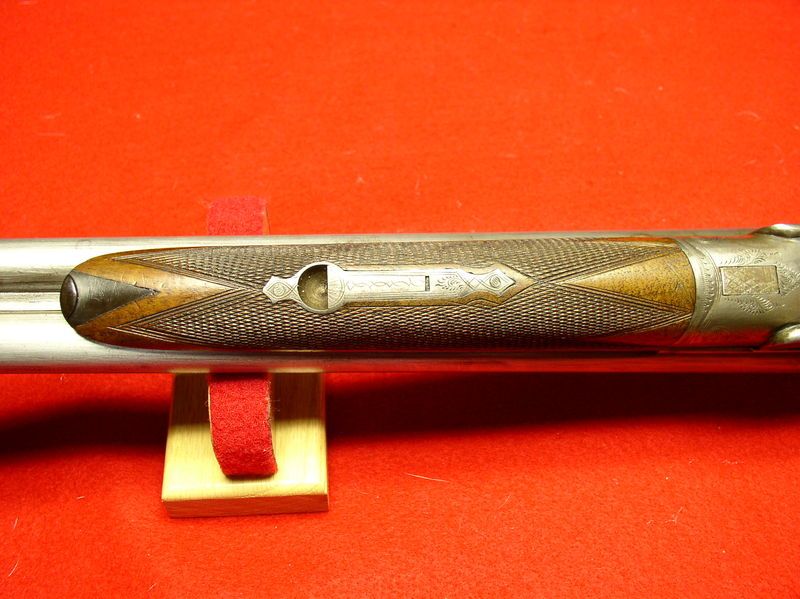

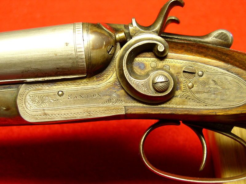

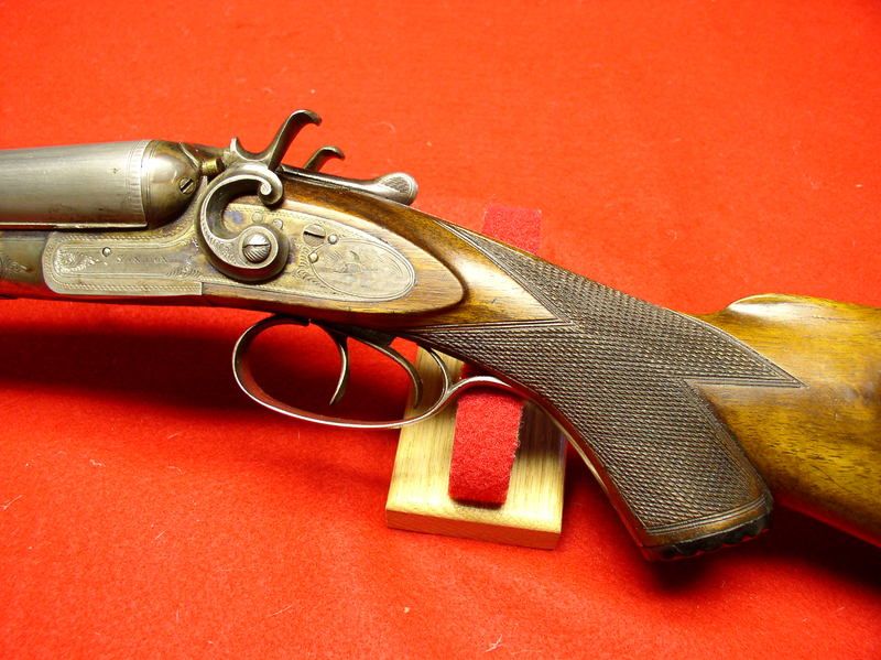

Bought a gun unknown to me at a gunshow today.

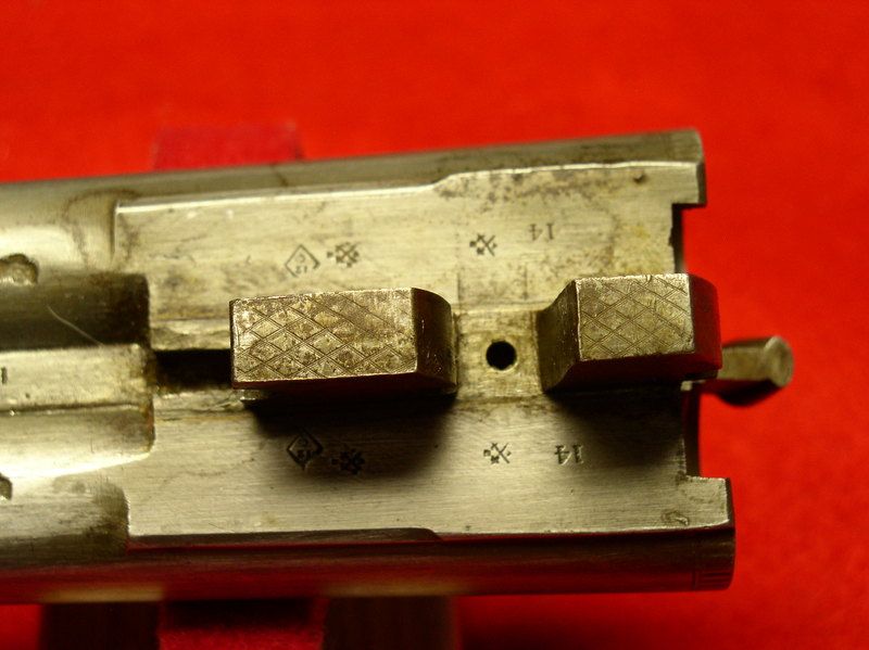

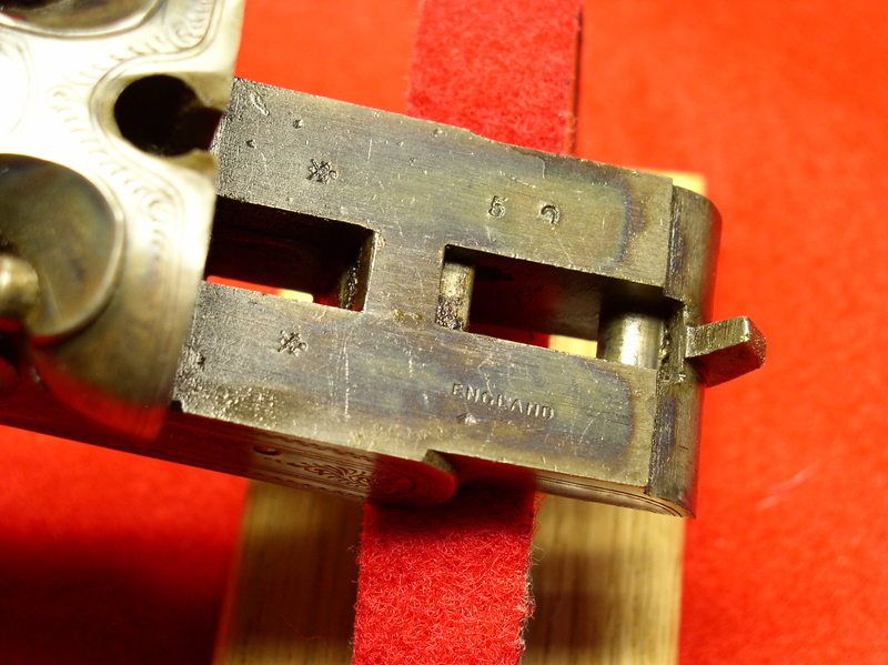

It is a 12 GA hammergun marked "SAXTON". Barrels and receiver are stamped "ENGLAND" and it has Birmingham 1868-1925 definitive black powder proof marks.
WHAT DO I HAVE???
Thank you!!!

A tough one. I've researched the name as well. "Saxton" appears to be a "Trade Name", used by an importer. I haven't been able to determine which one. The name is found on both Birmingham and Belgian guns. It's similar to other trade names like 'F A Loomis", etc, which were mid grade pre-1890 hammerguns made by someone in Birmingham. I can't remember right off the year guns were required to have country of origin stamped on'em, yours was obviously made after that date. If it was (probably) made "in the trade" you wouldn't necessarily know who made the gun even if it had a recognizable name on it, as that firm may have simply sourced it from "the trade". Nice thing is that the standards were fairly comparable for equivalent grade guns. What are the barrels, fluid steel or pattern-welded? They don't look right, possibly severely buffed or sanded?

the hammers and the action look to be fairly standard for the Birmingham trade. It may be the name of a provincial reseller.

Are you sure it is not American; it seems to have a flying turnip engraved on the lock plate. Just kidding, nice looking gun...Geo

Either that or "Hermes' Helmet". grin

Operating from memory here, but if I recall correctly the fact it has the 12/C chamber marking makes it a post 1887 date. Interesting it has 12ga chambers but only 14 bores. The intermediate bore markings began the same time as the chamber mark so these bores would have been no larger than a 14/1. 14ga = .693" with 14/1 @ .702". 12ga = .729". I have an old Birmingham proofed W Richards which also has 14 bores with a 12ga chamber, but it predates 1887 ( no chamber mark on it) . This gun could conceivably have had bores very near to 13ga (.710") when new. They measure very near that now but are badly pitted so cannot say how close they are to original.

1 The engraver had possibly never seen a "pheasant" in the wild only drawings and those hanging up it the butchers .
