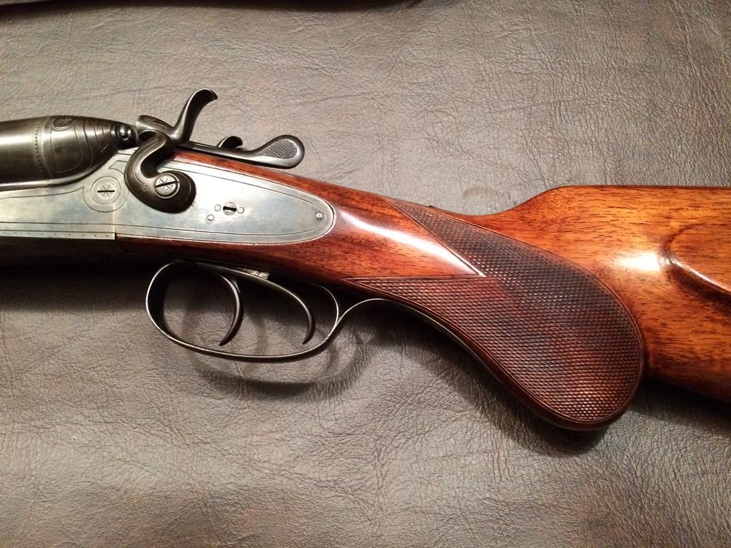

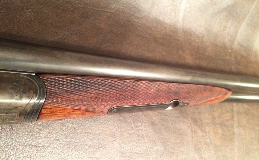

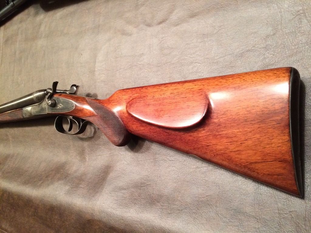

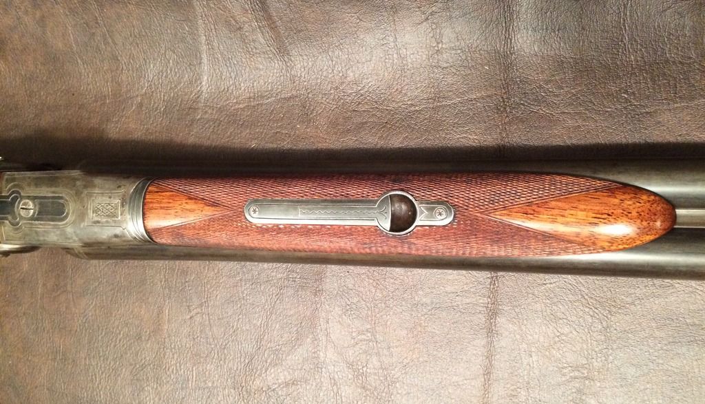

I just got my 16ga Haenel Hammer gun back with stock refinished and checkering re-cut. I'm quite happy with it.
Need to possibly lengthen one firing pin as I get soft hits and an occasional F2F.

Looks very nice.

It does, doesn't it Mark. I saw it first on another site and am as impressed now by how good it looks as I was at first sight.
