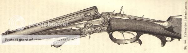

It's an early Collath variant made on components sourced from Liege. It looks to be post 1893 and experienced reproof in Oktober 1902 at the Zella-Mehlis facility.

A contribution by Axel E. on NE
Joined: Apr 2005
Posts: 1,798
Likes: 32
Joined: Apr 2005
Posts: 1,798
Likes: 32
An "Exhibition grade" W. Collath of similar construction on Guns International is valued at slightly below 3K. This of course is dealer's asking price, not a realized sale price.
The J.Specht seems to be in lesser condition. The 68 cm barrels were not overly common at the time (except on combination guns) so I would carefuly check about possible shortening. Also I can see no information about the condition of the bores which of course is crucial. Last but not least, W.Collath is a well known brand name, not so J. Specht. So, for the time being, I would not dare to value it over 1K.
