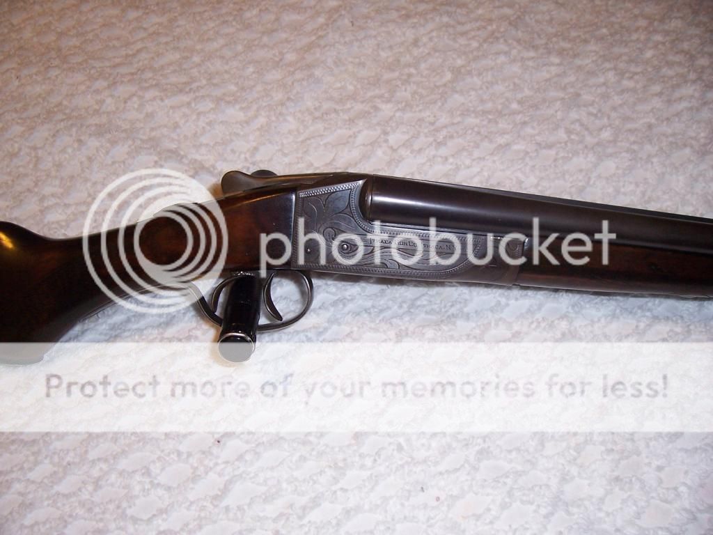

Here is a couple of pictures.

That is a beautiful specimen of the Flues.
Regarding weight, the 20 ga. version I used to have had a hollowed out stock. I don't know if they came that way originally.

Beautiful gun! Thanks for the pics. It should be nice in the field! Anyone know where the "Flues" name came from?

I LIKE that Grade I style of engraving. There, I said it! (To me, it's just about IDEAL!).
