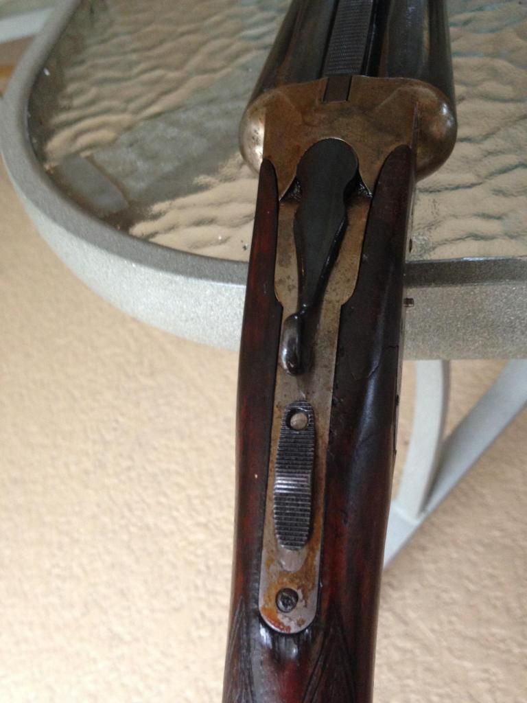

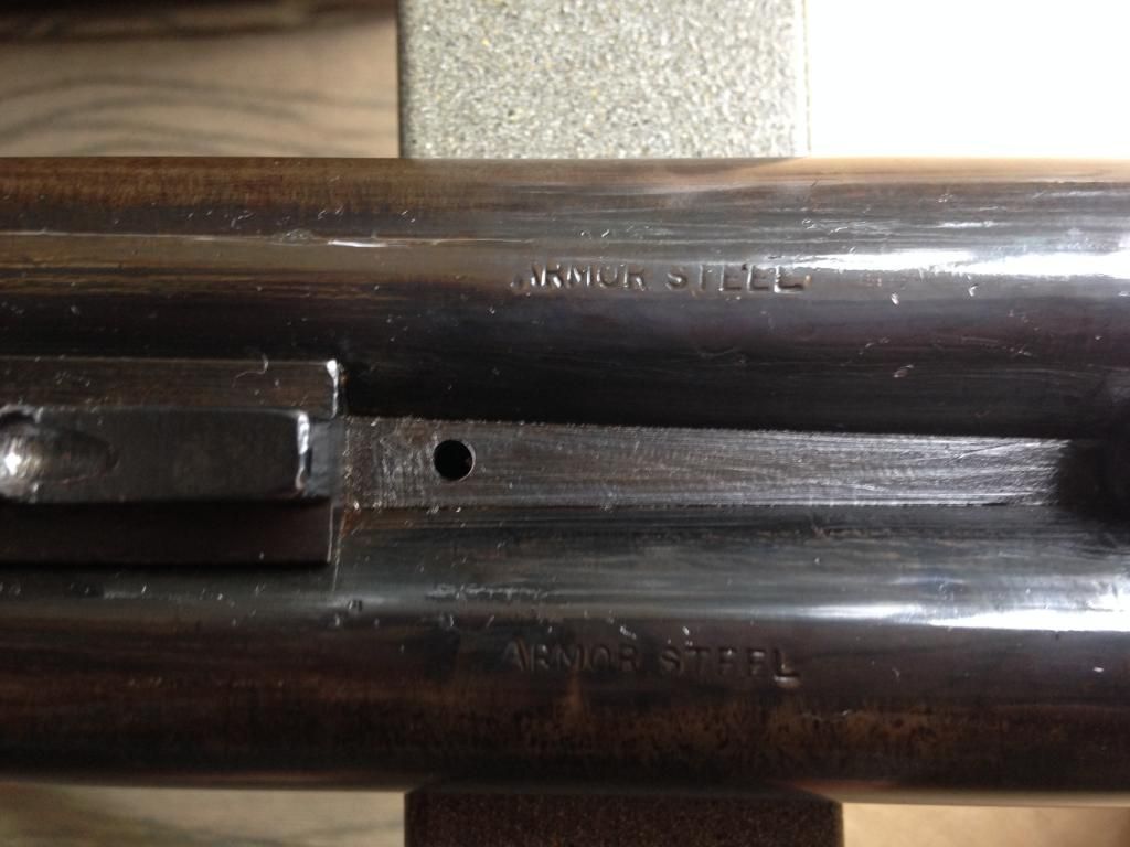

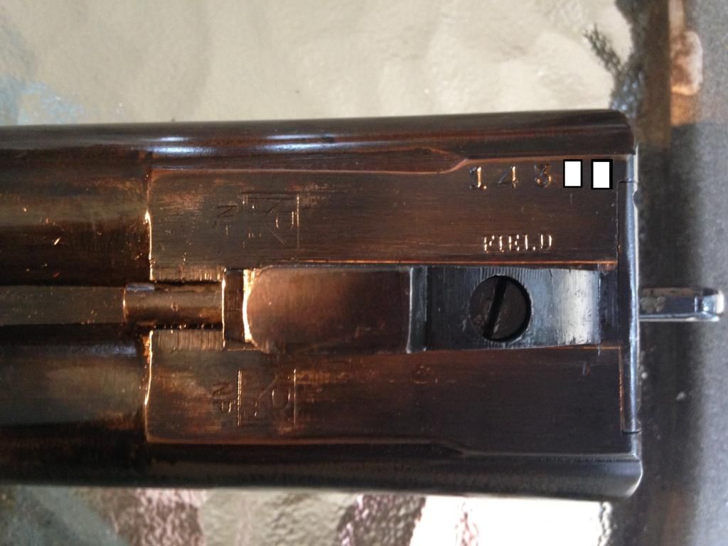

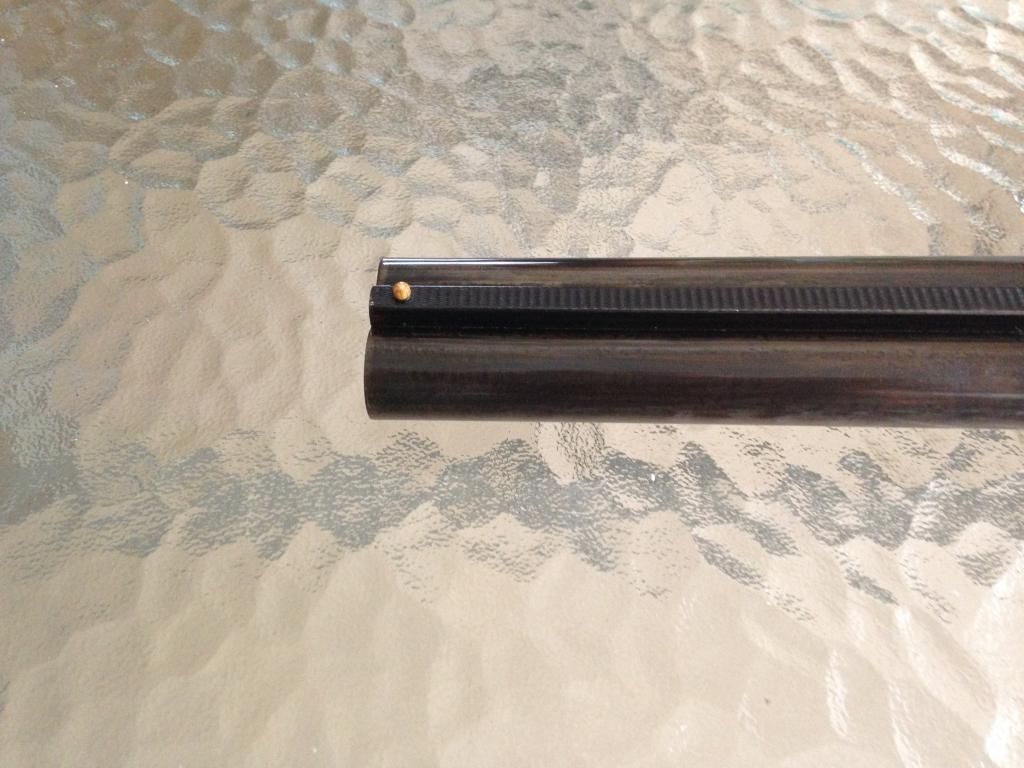

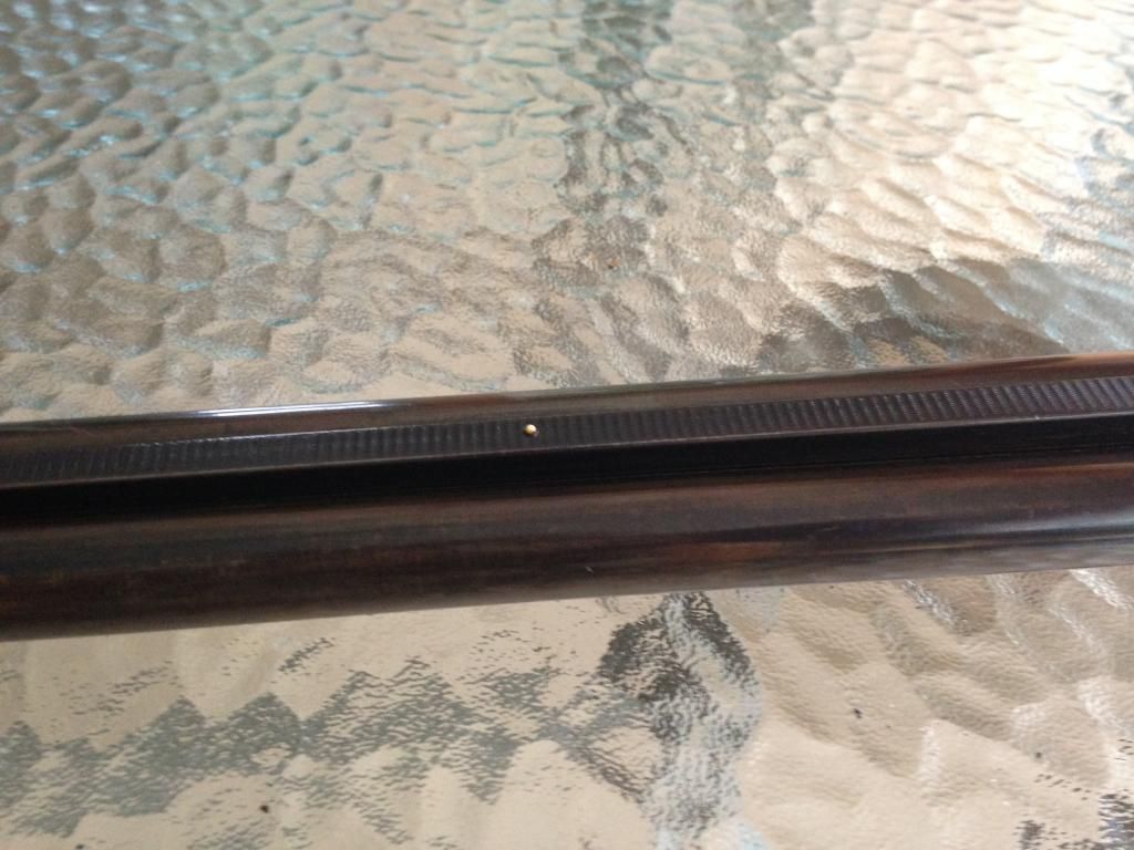

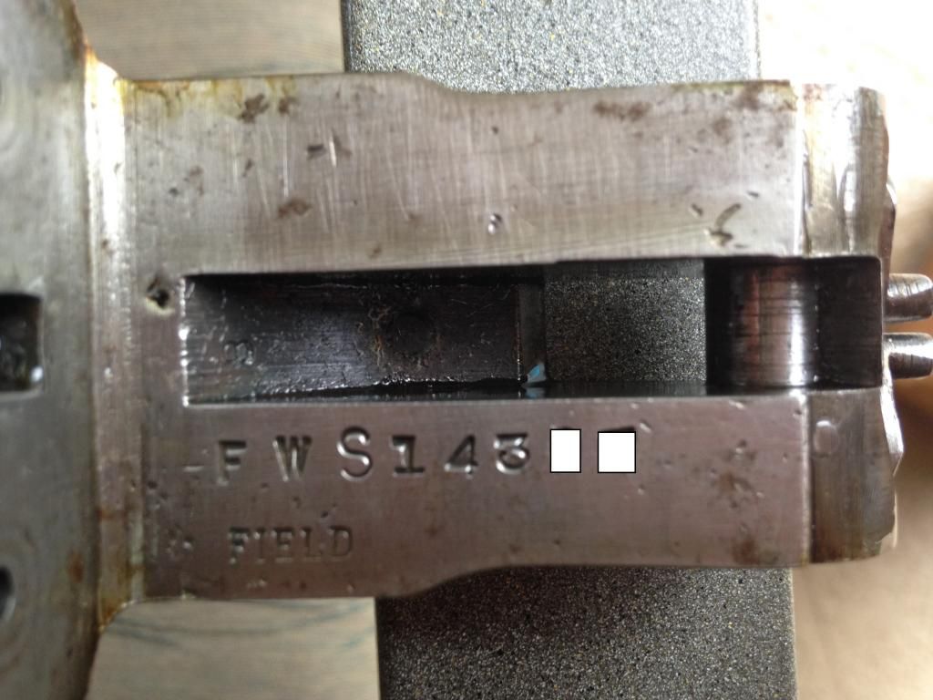

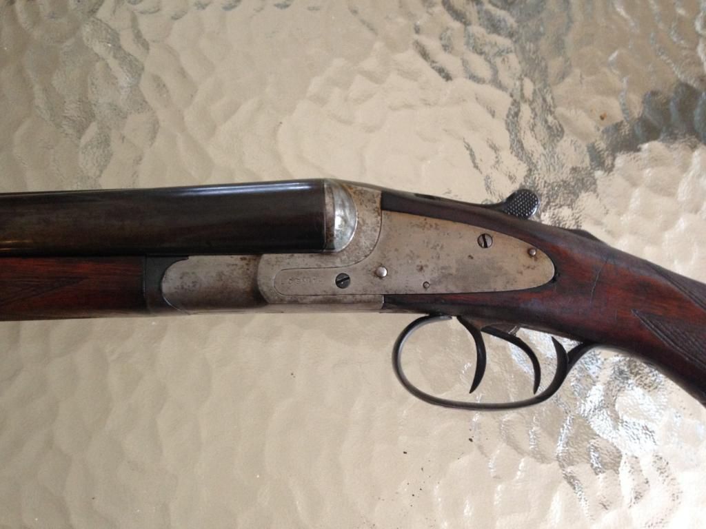

Picked up my first LC Smith. It`s a field grade in very good condition. Bores are near excellent, locks up tight and everything. I haven`t got to shoot it yet. I could use any info ya`ll have on it. The serial# FWS 143xx. It has double beads and I think their ivory but I haven`t got to cleaning them yet. The top of the right barrel reads " L C SMITH FIELD GRADE " The bottom of the barrels read " ARMOR STEEL " On the flat of the barrels where they fit the receiver is a proof mark. It is a square with a " P " and some sort of design. Under the "P" it looks like " A GO " Under the square is an " N P " The barrels have nothing to indicate what chokes they are, and their 29 3/4" My phone took a crap so that`s why I`m not able to post any pics. So with all that said I`d appreciate and help you can offer. I do reload and would like to know what components and pressures you`d suggest. I can`t wait to take it out for a test run but it`ll be a couple weeks.

Burch, the FW means Featherweight, the S means it is now from the L.C. Smith Gun Company a subsidiary of Marlin Arms.
I think you put a 1 in front of the serial number, maybe it should be 43xxx which would be from 1949. Serial number starting with 143, would be from 1935 and would not have the prefix FW S.
The marks you see are proof marks. Having two ivory beads would be unusual, most just had a brass front bead. The barrel length means it was cut, as both Hunter Arms and Marlin did not make any fractional barrel lengths mostly even numbers, with a few exceptions of 27".
I would stay with loads under 9,000 psi and around 1200 fps. I would not use any magnum type loads.

no sir, it does have a 1 to start the serial number. Same number on the barrels,forearm and receiver. The receiver has the "FWS" before the serial number.

Then that is a new one on me. The last serial number in 1950 was 56,800. The new serial numbers that started with S began in 1946 at FW S1.
If you could, post a few close-up pictures of the barrels water table, the receiver, and top of barrels. If you do not know how send them to my email address jdw110@live.com
This gun should have the high rib or what they called Single Sighting Plane rib.
This is very interesting.
Also I did look at the new Records book that was recently put out, and they did make some Field Grades with 28 1/4" barrels and some with 28 1/2" but none 29 3/4". Hopefully yours were 30" and you will still have choke, if 32" originally you would just have a slight taper.

Don't understand the serial number confusion; he listed a 5 digit number that would place the gun in late '46/early '47 Marlin era production? By the way, I believe FWS serial numbered Smith gun production commenced in 1945.

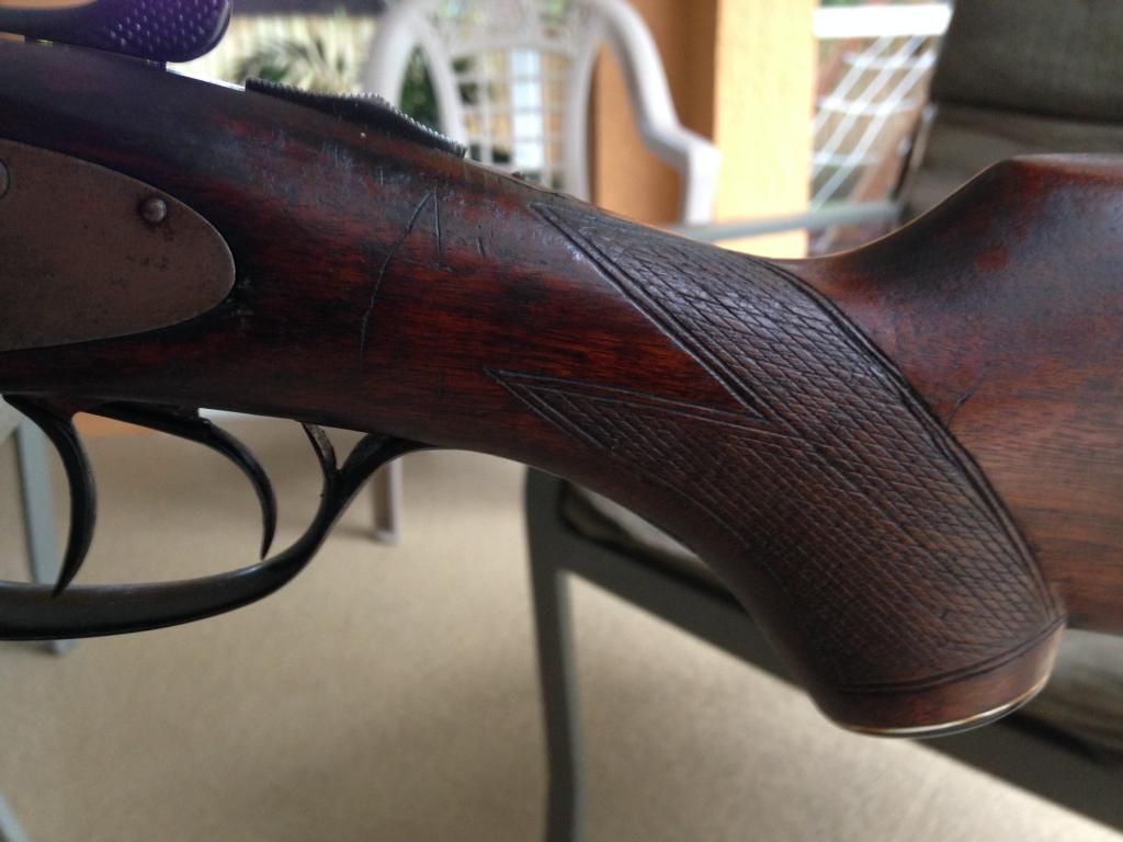

There is no reason to use low pressure shells in that gun. It is a post WWII gun and designed for modern loads and normal length shells. It would be a good idea to have the head of the stock glass bedded to insure against cracking as LC Smiths are liable to do, but there is no reason to spend extra money and effort on low pressure shells.

Burch: very few vintage doubles couldn't benefit from a good check and clean, and as Tom said glasbedding the head of the stock would be a good idea. Smith chokes were not indicated on the gun, so they will need to be measured.
