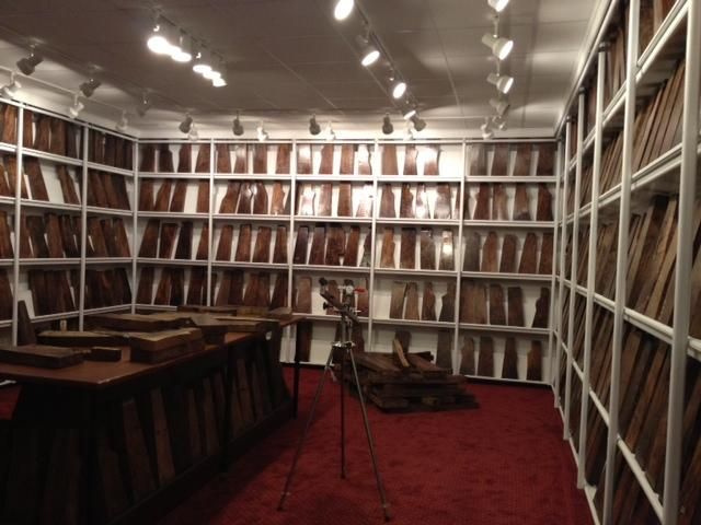

When I visited CSMC last year, they had this library full of beautiful Model 21 cocking mechanism wooden blocks. wink
