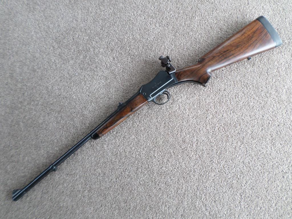

I also had problems with open sights and got around it with a P/H peep sight.
18" barrel which came off a 9mm Manlicher and slugs out at exactly .357 and breech block bushed. Was originally a 22 R/F.
No more trying to align front and rear sights and so light to carry.
Real pussy cat to shoot and so accurate.
These little Martini actions must rate up there with the best or even better.
What other easily available rifle action can you take out the working parts by taking out one little screw.
OK so you are limited to calibre, no big booming Magnums but I have found my Martini 7mm Waters ok.
Looking forward to getting my hands on my next Martini in 5.6 x 50R

I like it. Is your 7 walters on a cadet frame? Or a model 12?
I wanted to go with a waters but was worried it might be to long or to hot for the small action martini
Really a great gun. Good trigger right out of the box. I have a 22 lr model 12 (I thnk) I bought for skb. Target gun. With parker hale sights. Can't decide what to do with that one
Jerry

No not a Cadet, another 22R/F not sure of the model but of the type that has the thicker side walls to the frame to give a bit more meat there.
Topped with a two and a half power 7/8" German scope for ease of loading.

Maybe this will work
