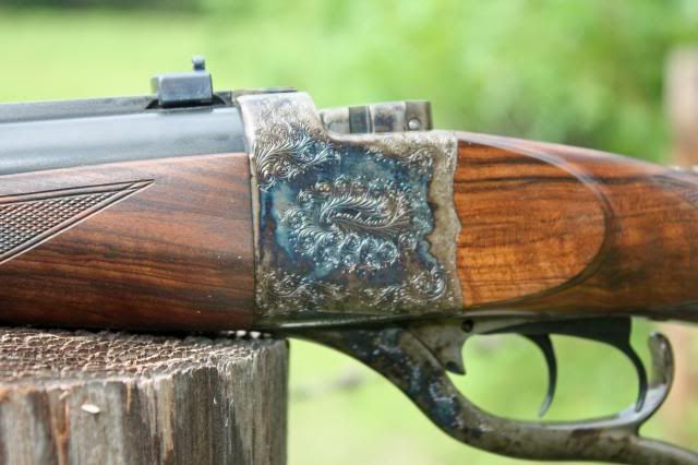

I wished I knew what kind of witchery was occuring at the St. Ledger workshop during CCH'ing.
Heres where im at with it:

Gunmaker, you did that color hardening yourself? It really looks fantastic! Do you color harden for others?
Posts: 11,412
Likes: 1821
Posts: 11,412
Likes: 1821
Agreed, that is more than close enough. Beautiful work.
