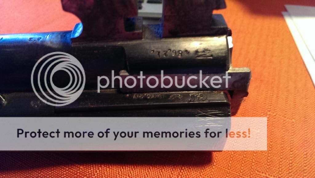

Am needing help in identifing a drilling that we discovered within father in law's collection, after his passing.
Markings on top of each barrel read: 'prima essen" with "gewerhrlau stahl krupp" marked within. Also, looks to be crossed swords in center of same?
There are of course several stampings of numbers and markings under the barrel, that I can provide pictures of, if I can be advised how to do this.
Thanks in advance.

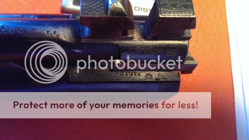

These inscriptions merely advertise the source of the steel used in making the barrels. Translated it reads: "First class gun barrel steel by Krupp (steelworks) in Essen (city)". We need all markings under barrels, on watertable and, perhaps, on breechface. Maybe these markings will allow to identify the real maker, but at least they will serve to identify if Suhl or Zella-Mehlis, caliber and date. PM sent.

1st pass in Ferlach in 1919 with 14.5mm on the scattergun tubes and 7.5mm on the solid projectile tube.
Final pass in 1921 with 15.4mm on the scattergun tubes & 8.2mm(maybe Peterlongo?) on the rifle tube - need a length or chamber cast

I agree with the need for a chamber cast, though I rather suspect a 8x50R Mannlicher. While the German proofhouses stamped the bore diameter on rifle barrels, leading to lots of confusion now, the Austrians stamped the groove or bullet diameter.

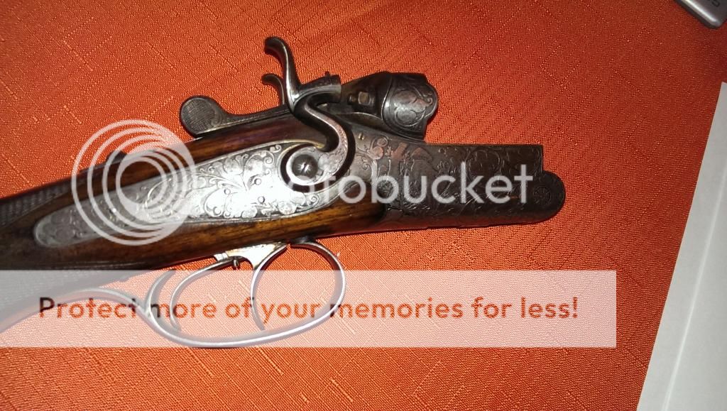

Now the question is, is that a crack between the slots in the bottom of the receiver? Lordy I hope not!!!!
