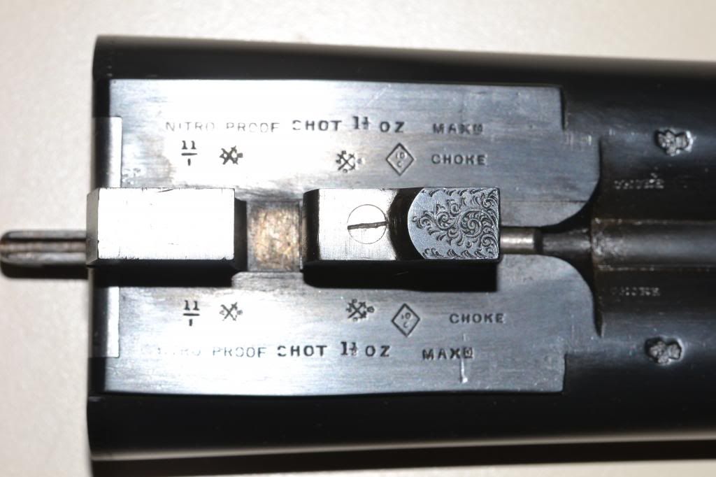

Here is a picture of proof stamps, W&C Scott Monte Carlo B 10ga barrels re-blued
Current measurements 2 7/8" chambers .777/.776 bores, min walls .035/.040, chokes .037/.037
Thanks I can't read proof stamps.Is this gun still in proof? Thanks

Craig,if the bore measurements are correct the barrels are just out of proof. 11/1 covers bores up to .775. Suggests that some fine boring has occurred, probably to cleanup frosting near the chambers. the nitro proof marks are circa 1896-1904

Thank you. Craig

Thanks Joe but I am using a Galazan bore gauge with a .775 ring. I believe the measurements are accurate.
I am sure Terry is correct in his assessment they were lightly honed in the past. They still have great wall thickness in front of the chambers and 9" from the breech. Boy does it shoot great patterns!

BTW Craig, that is a very fine shotgun.Congrats if you are the owner. Love the rounded bar action and great condition. Wouldn't
loose sleep over the slightly out of proof...
