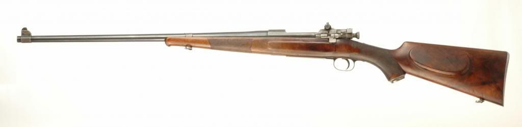

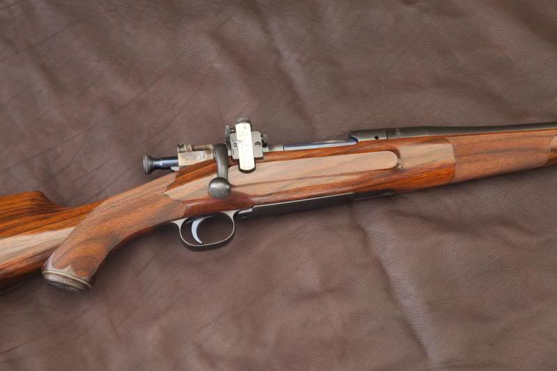

Thought you folks might enjoy Nathan Heineke's interpretation of the Whelen-Wundhammer rifle.
Nathan had this to write about the rifle.
"You may be interested in these few notes regarding the rifle:

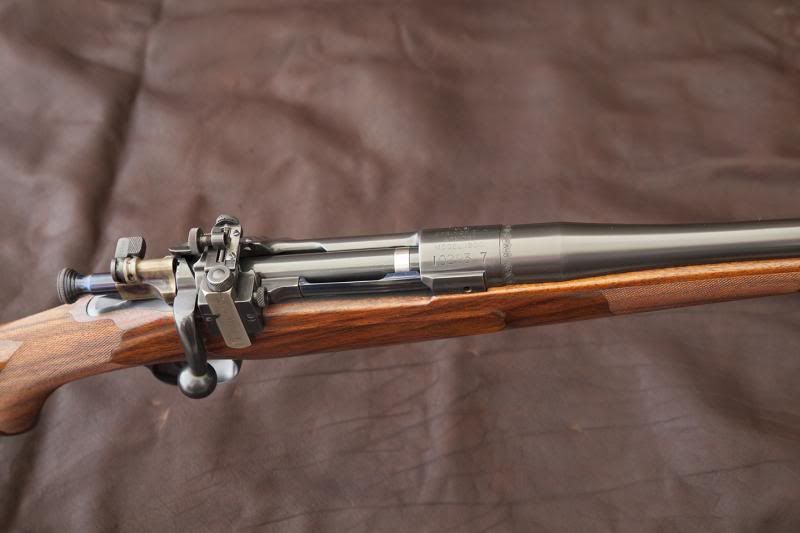

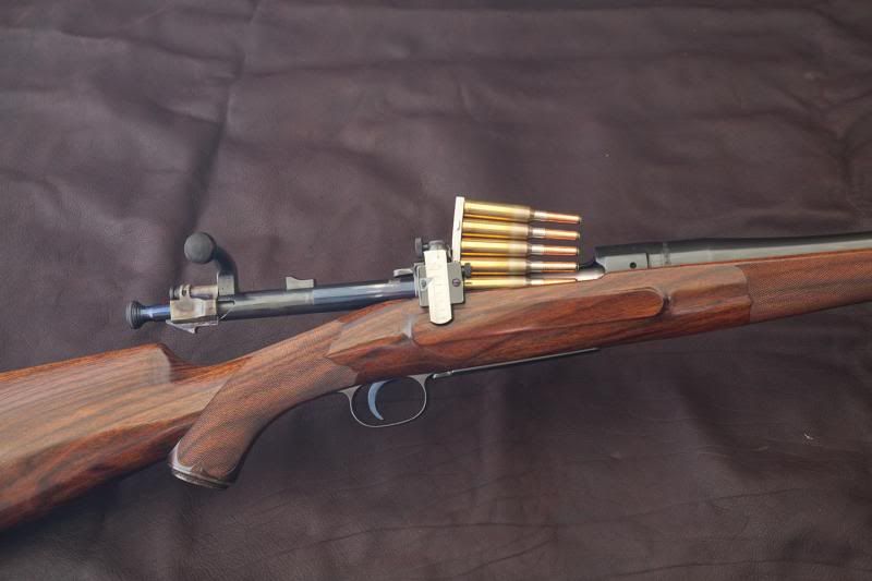

-With the exception of the blank of from-France French walnut (estate sale in California), all the parts were either leftover, re-built and reconditioned, or fabricated in the shop. The receiver and bolt were reconditioned then re-heat treated. I fabricated the front sight ramp, the Lyman 48 base, barrel-band, and swivel studs.
-All of the wood and metal finishing done here in the shop.
-Lyman 48 staff is matte nickel plated.

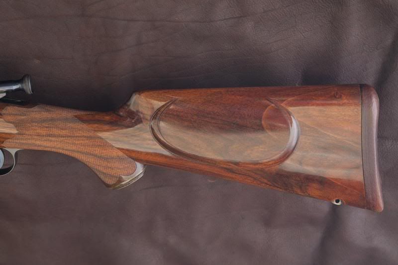

-The stock is the same dimensionally as Whelen's except a shorter LOP. The cross-sections, however, are of different contours even though the widths are the same. Fills the hands better. The grip has a modest diamond cross-section hidden by the checkering.
-Bolt lift is a measured 5.5 lbs. and WITHOUT lightening the mainspring!
-Caliber is 6.5x55, barrel length 26", weight 7 lb. 14 oz., balance: unbelievable!
I did not want to do a laborious and dogmatic reproduction of the original sporter. Rather, a rifle done in the spirit and nostalgia of the original, with respects to both Wundhammer and Whelen, but also with influences of my own."

I held and looked this rifle in the white with some wood left to be removed. The balance I would compare to a scaled frame, 30" barreled .20 gauge double. The 6.5mm bore puts just a touch of weight forward and with the 26" barrel holds like a rock. It is nice almost beyond description. Nathan has a deep understanding and appreciation for the way things should be done. I have an interesting rifle in his shop that I am looking forward to discussing with everyone soon. GED

Truly a nice rifle. I love the "Mauser-esque" side plates.

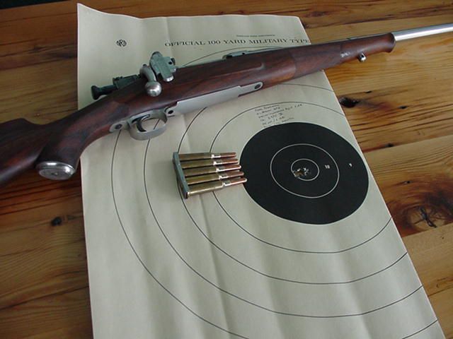

It also shoots as well as it looks, shot at 100-yards.
Nathan wrote, "5 shots in to 7/8", 4 of which went in to 7/16" at 100 yards."
