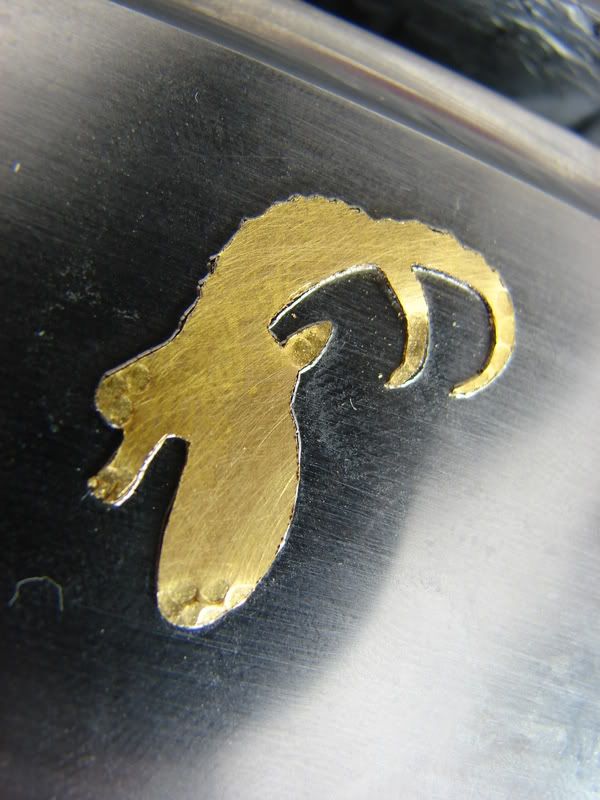

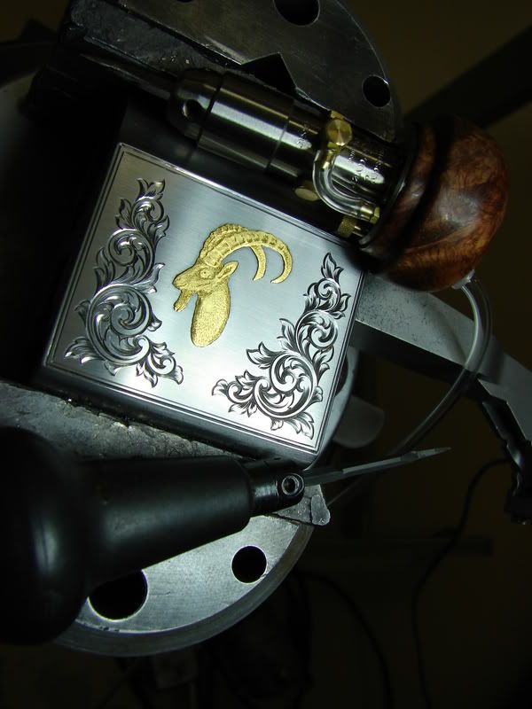

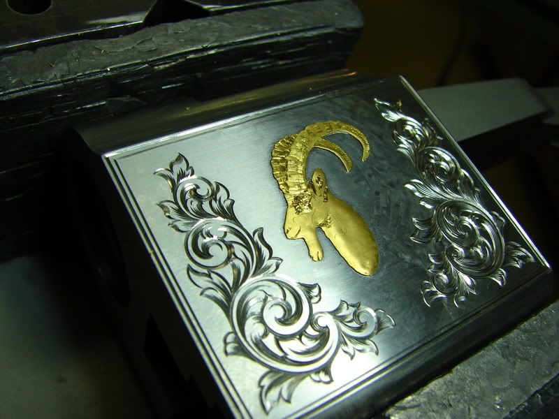

I took some pics of my work recently,a simple job. It is the first completed panel with my new Lindsay palm control. The Lindsay is a patented handpiece that is the latest thing available in hand engraving technology

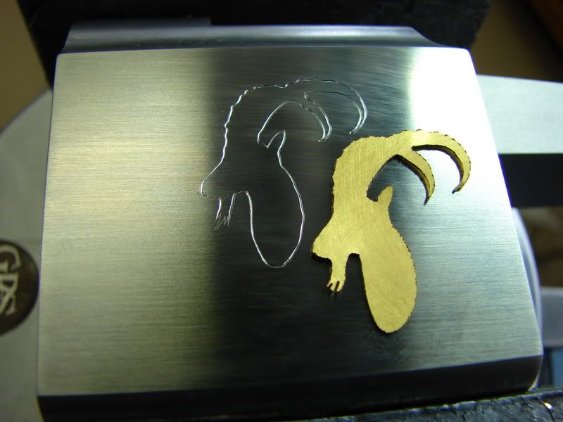

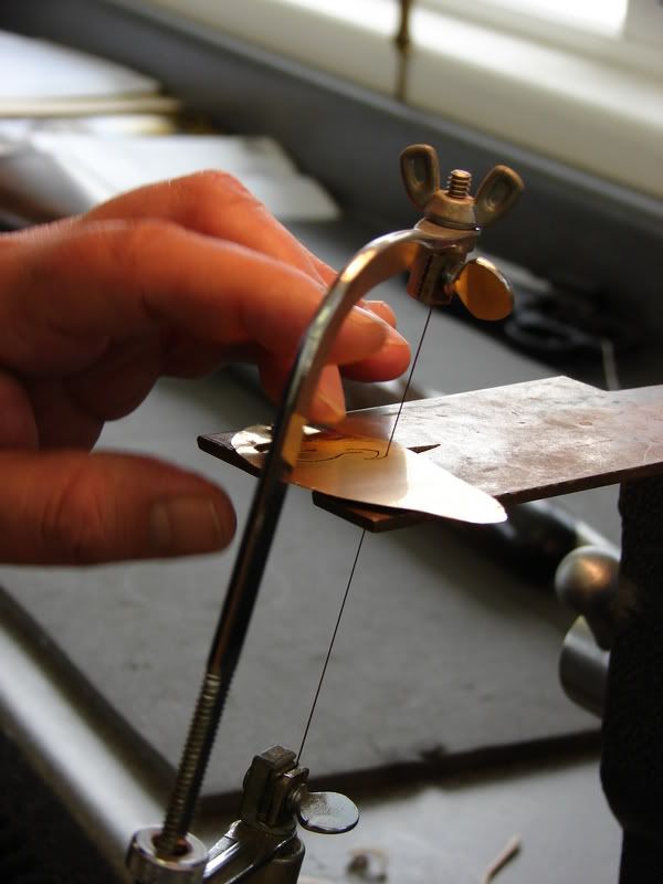

First we saw the sheep from .010" 24 k.

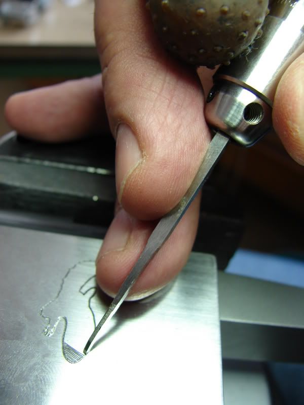

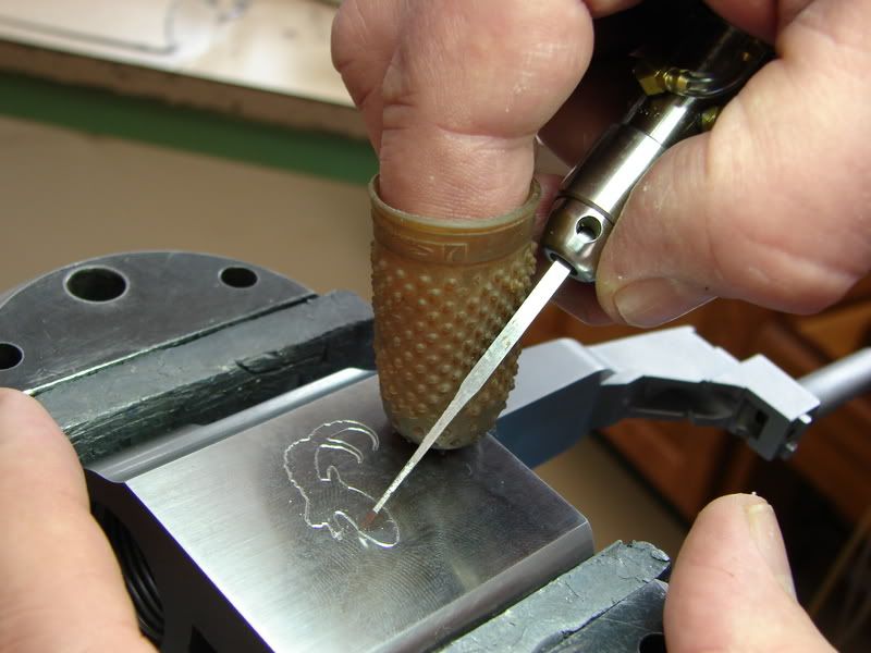

Then we cut a shallow line around the area to be Damascened, and make sure the sheep fits.
The the edge is under punched with a flat, just like an old school inlay.

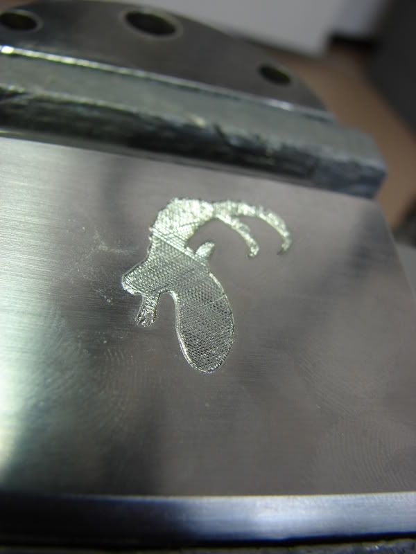

Next the background is scored with sachet'd flatback.
In two or more directions.

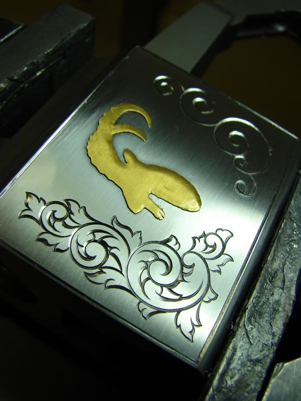

The gold is installed, and punched down at the extremities first.
Then it is peened.
And burnished till flat, and blended with steel wool.

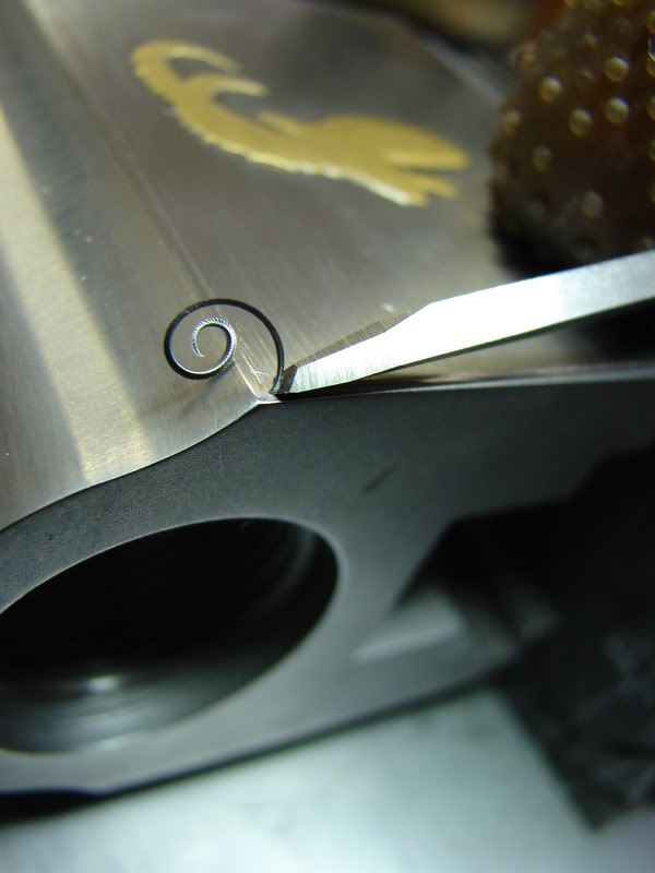

The borders are cut.
Then the scroll.
And then carved, punched and bulino'd the details.

Very nice work-thank you very much for sharing. In addition to the gold work, I really like the way we can see the scrolls progress from blank steel to finished product.
Did you do this under magnification as you have shown in other pictures?
not to pick nits, but an ibex is part of the Capri (goat) family. But i will let it slide this time!

I use a Meiji EMZ 8TR stereo zoom trinocular microscope.
