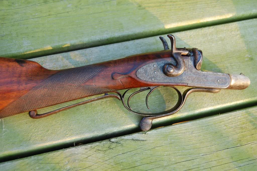

Hi All,
This Perrins shotgun has just surfaced and it is intriguing. It looks like it was originally a pin fire which has been converted to centre fire some time after 1887 which is not too unusual in itself – but what is unusual is the grip safety. Now I have been around guns for a good few years but am no expert and this is the first time I have seen this on a shotgun. The gun has non rebounding hammers, as you would expect on a pin fire conversion, but I would appreciate it if anyone can shed some light on the grip safety. How rare are these? And would it have been original? The hammers are locked when fully cocked till the grip is squeezed.
As any of you who have followed my threads on the Perrins guns over the years will have realised – they were very innovative and progressive. We have uncovered all sorts of different actions from false hammers to safety catches that work the opposite way from convention to underleaver and top leaver cocking – but I haven’t come across a grip safety on one of their guns before. I am sure there will be lots of you out there with examples or the knowledge so any information would be welcome
Here are a few more photos of the gun – it isn’t in great condition but with a little – well actually quite a lot – of TLC it should make a good recovery.
John

Hi John,
Nice gun you have there, I have a Dickson with the same 'grip safety' as your Perrins, my gun is dated 1863 and is also a pin-fire conversion.
It is a rare thing to come across. Looking through the Dickson records they built 18 muzzleloaders, 24 breach loaders (centre and pin-fire) and 8 hammerless guns with this 'grip-safety'.

I also had a Dickson, pinfire conversion, rebounding hammers, with a grip safety, and a Brazier snap bolt. I am not sure if the internals my grip safety are like your, but on the outside they look the same.

Grip safeties are older'n Methuselah. Here's one from circa 1815 on a W.H. Wilson, London. I believe it was a Manton innovation which merely blocks the trigger blades. Intent was two-fold: to help prevent blowing your head off whilst loading, and supposedly allowed safely carrying the gun fully cocked for rough shooting. Only problem is I tend to grip the wrist while walking.....not a good idea with this arrangement. (These late flintlocks were often built as self primers as this one is so were loaded with frizzen closed and hammer at half cock.)

What a cracking gun. As you say - there isn't anything new - even back in 1860!!
I had thought it a bit tricky to carry it cocked without holding the wrist of the stock with one hand - it just felt a bit awkward holding it further back.
John
