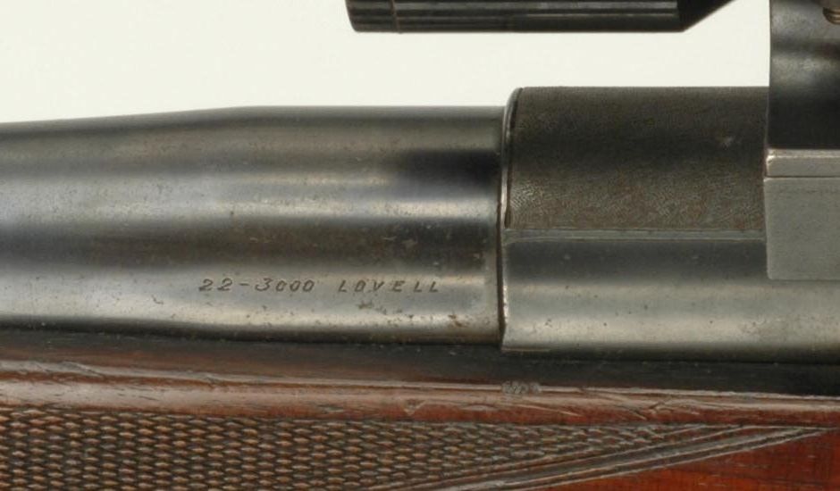

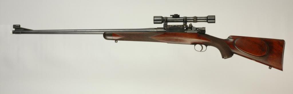

I have seen G&H 1922's converted to .22-3000 Lovell, .22-3000 R-2, .22-Hornet and .25-20 Single-Shot.

A G&H in .22-3000 Lovell.
