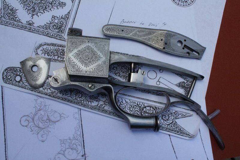

I just got an email from Roger Sampson saying that he had finished engraving a now nearly completed Alex Henry.
Roger sent along a picture. Looking forward to seeing it when it is delivered.

Lovely! Roger does great work. his miniature stuff is just amazing.
Outstanding, thanks for sharing.
Posts: 465
WJL Offline
Posts: 465
Beautiful. I don't think any engraving is quite as beautiful on a classic single shot rifle as tight, well executed scroll.

Stunning....simply stunning.

Jim, first I think your metal work is outstanding and Roger's embellishment only adds. Really nice you must be proud.
Jerry, I believe Rose and Scroll also fits you comment. IMHO
Fraser single shot also done by Roger.

Very very nice. I'm looking forward to seeing pictures of the completed project. It's shaping up to be a real gem.

That's probably the best English rose and scroll I've ever seen.

Thanks Ryan or should I say thanks Roger.
Jim W, what are your plans for finishing the metal on your Alex? We are looking forward to seeing it.

Finishing the rifle will be about like this:
Rust blued barrel
Niter blued trigger guard, tips and toes, and the screws
Color hardened action, trigger plate and lever. I like to soften the color hardening just a bit using a "Q" tip and Semichrome polish very sparingly. This seems to mute the 'in your face' look of new colors.
