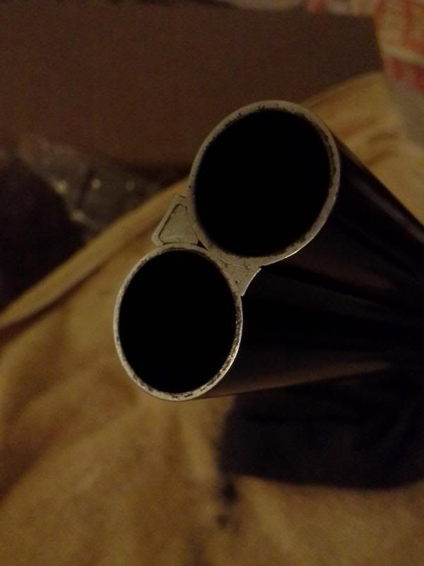

Posts: 711
Posts: 711
Typical 21 muzzle. I've got 4 std rib guns and they all look about the same. JW

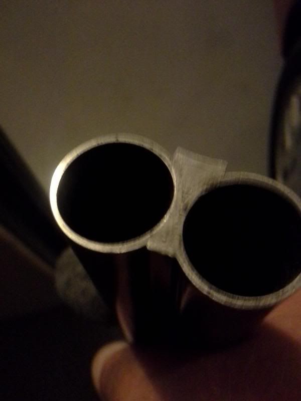

Posts: 711
Posts: 711
Another 21.
Posts: 863
bsteele Offline OP
Posts: 863
Thanks 12brd - that's what this one looks like.
