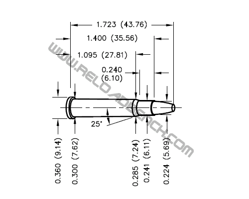

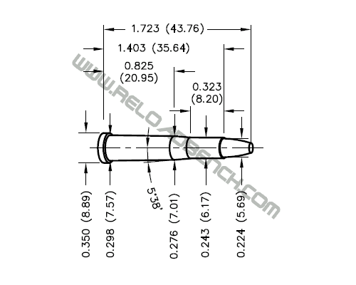

Here is the dimensions of the two.
22 Hornet
22Hornet Improved Niedner
