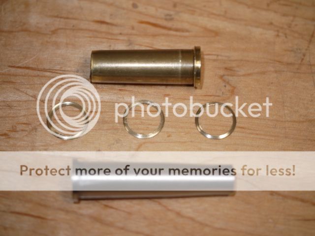

The barrel will accept a ,305" pin gauge but not a .306" pin. A chamber cast showed that it indeed is still chambered for the 8.15X46R cartridge and that the grove diameter is .318".
When I finally realized that the rim depth was .065" , I made a test cartridge from 30-30 brass which filled the rim recess but still left me with .012" of headspace. I then made a .010" washer to fit over the test cartridge that gave me a rim thickness of .075" and solved the headspace problem. I'll attach a picture of the thicker case head and the adapter.
I have a 32-20 reamer as I like to reline shot out 303 and 8mm barrels for this cartridge. I considered the 32 S&W but I have neither a reamer nor cartridges for that caliber. I probably have boring bars small enough but have never tried to cut a chamber that way.
A gunsmith friend suggested that I make a washer similar to the one pictured on the test cartridge and that I solder it to the rim recess. I plan to try that approach while I await the 8.15X46R reamer, as it is simple, reversible and preserves the original parts.
Otto
Top. The Test case with washer attached and additional washers below. Bottom. A 8.15X46R adapter chambered for the 32-20 cartridge.

Otto,
Great info.I wrote an article on loading for 8.15x46R once, using examples of different rifles I had acess to.A chamber like this,with such a deep rimrecess would have added another paragraph to the article.I was resistent to the shims,thinking you meant a shim for each case.Your friends idea to shim the recess makes a lot of sense( a common way to correct excess headspace in shotguns)since only one would be required and normal shellholder could be used.The info about the barrel accepting a .305" pin gauge is interesting also.Usually owners of these rifles have the wherewithal to measure groove diameter but don't have a set of pin guages. This is another piece of info to file in the back of my mind.I guess I need to PM you,I'm about to get a little past the intent of this thread.

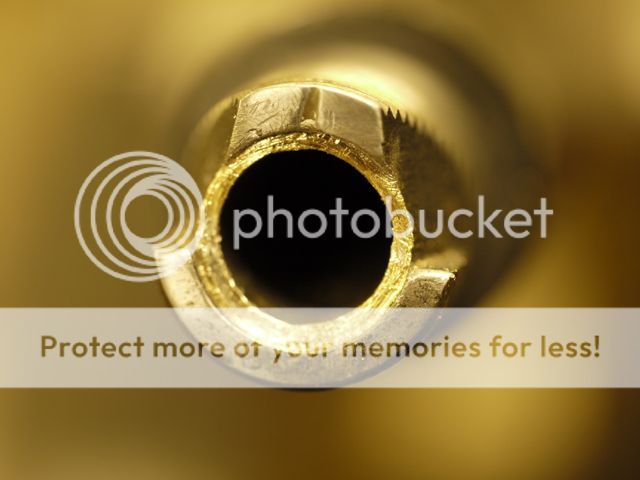

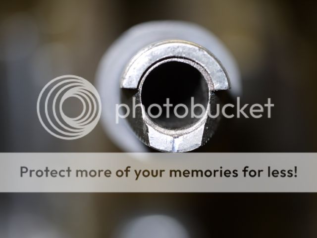

Mike,
A spacing washer in the rim recess seems like an elegant way to solve the headspace problem without additional changes to the original rifle.
The washer is about .005" too thick and I'll use the chambering reamer to set the final headspace, so it will be awhile before this story is complete.

Rim recess before spacing washer

Washer soldered in place
